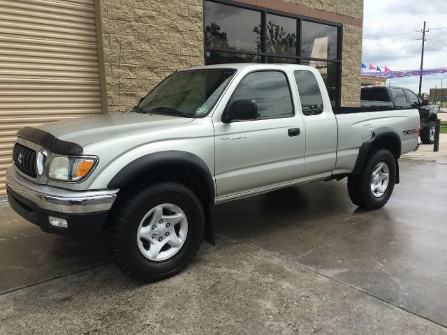

    Hey guy I'm new to the site. Just picked up my first toyota. Its a 2004 Tacoma TRD 5 speed. So far I love more and more every time I drive it. I put a K&N intake and a 44 series flow master on it so far. Fixing to order a throttle body spacer as well when I order the leveling kit.
    I looking at the ToyTec 3" strut spacers with a 2" Add a leaf with extended shock. What are your opinions!?? It seems to be a decent kit from what I read. I dont plan on Wheeling my truck and beating on it. Its my daily driver BUT I do go climb some hills from time to time. Will this lift be good for what time doing with my truck.
    Here is the Link http://www.realtruck.com/toytec-toyota-lift-kits/R183947P2004Y608MA.html

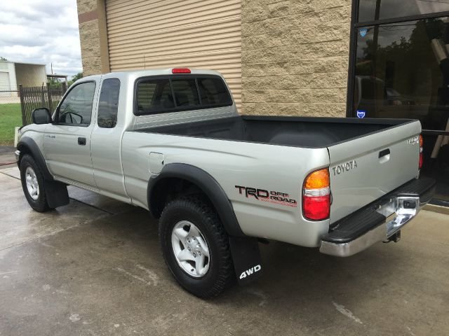

    Here is a couple pictures the day i picked it up. Does have black plastic dipped wheels now.
    0AB164BD-3529-458B-AF93-58FE8308577F_16.jpg 0AB164BD-3529-458B-AF93-58FE8308577F_24.jpg
