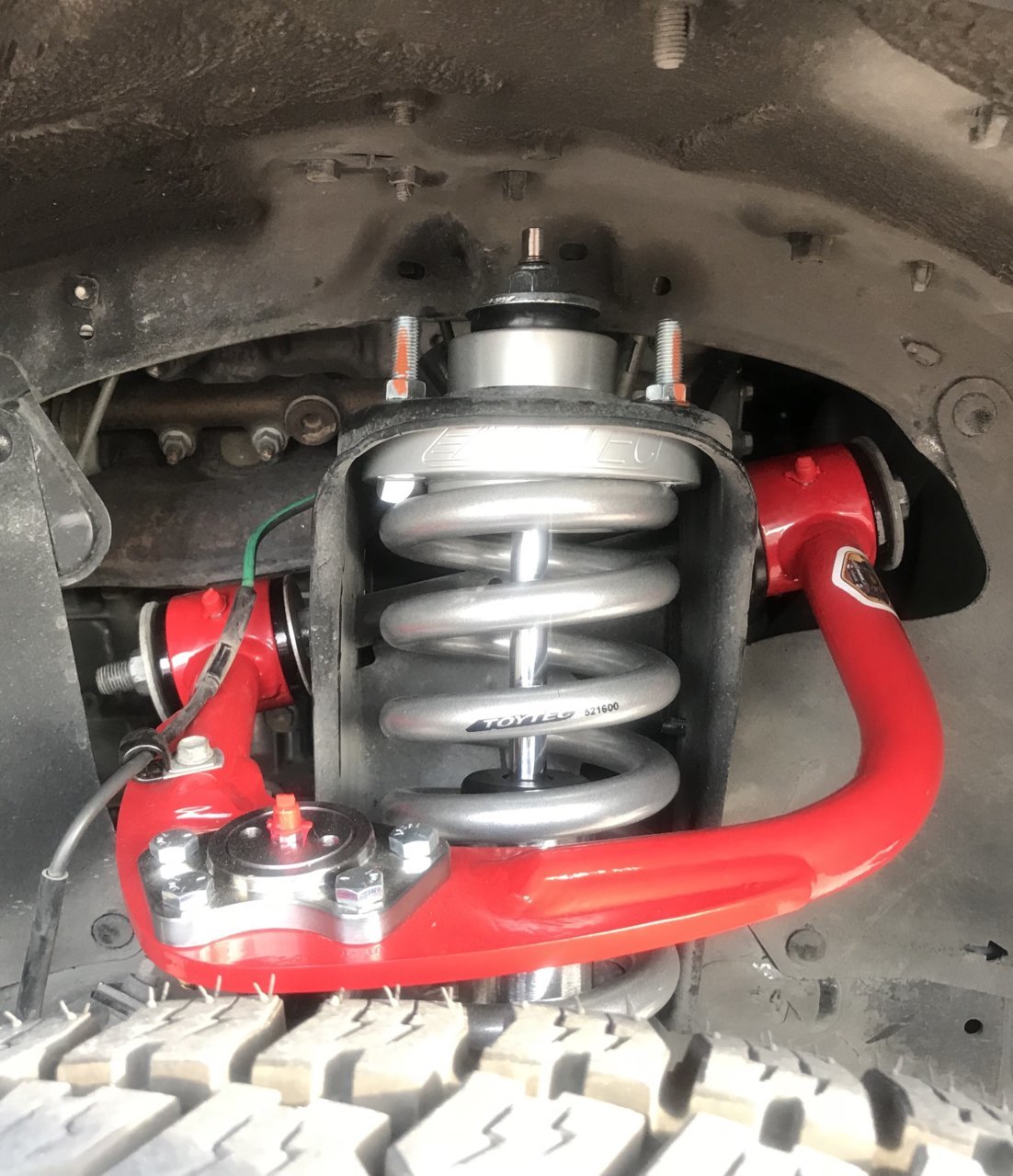

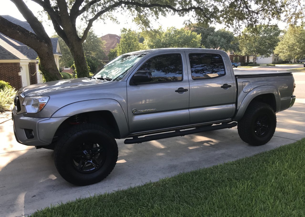

    I went with the Toytec 3” coilovers and a 2” block in the rear, pretty much my street truck. Also went with jba ucas. Running 17x8.5 -10 and 285/70/17 no issues. Just removed mudflaps and caster at 4*. DDFF6EBB-496B-4A59-98C4-17BE7785FE4C.jpg1398CFA3-A2F1-4A80-A299-4E7254E36DF0.jpg
