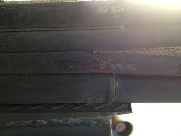

    My AAL cracked after around 36,000 miles. Here is a close up:

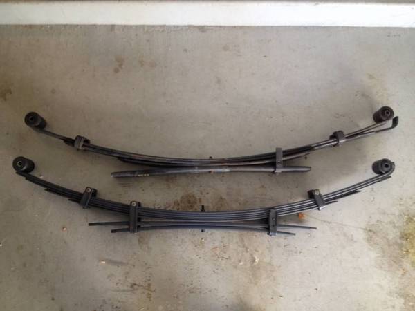

    Replaced them with OME leafs, here is a side by side:
