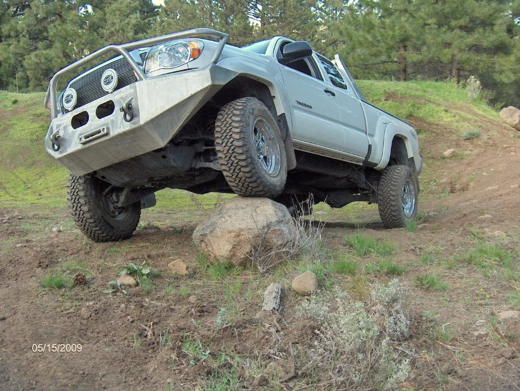

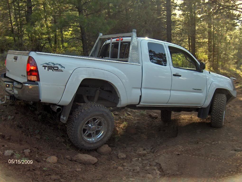

    I'm running the TSB leaf pack with a 1.75" lift Wheeler's Tundra AAL and a 1" block set with a pair of 5100's that have the toytec extenders bolted on them. The 5100's didnt have enough down travel with that much lift in the rear initially, but with the extenders on them the rear end works awesome. Rides smooth, and has tons of flex too- just check out my avatar pic and you'll see what I mean about flex.
