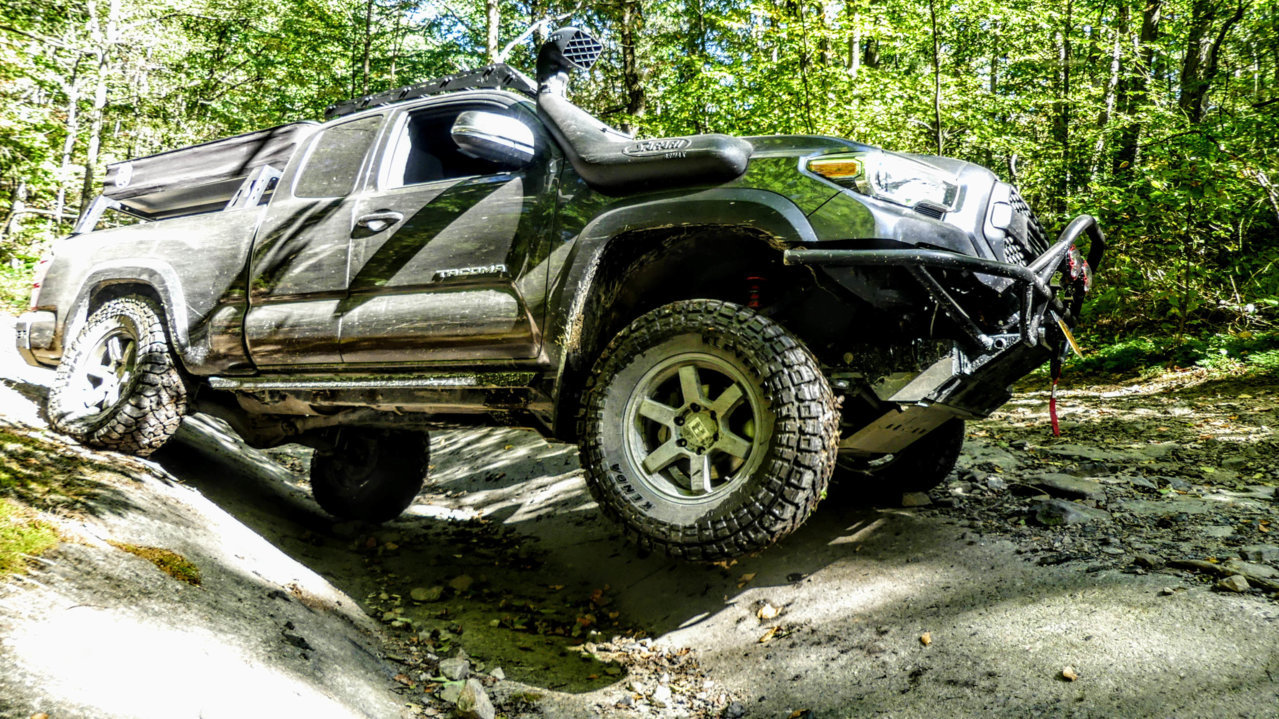

    FreshOldTaco[QUOTED] likes this.

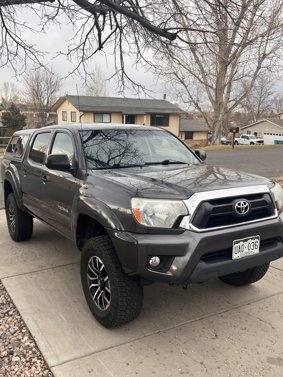

    Just installed my Toytec Aluma 2.0 kit a few weeks ago with some extra add on’s and so far I’m very happy with what I got. My build so far goes as follows:
    Front:
    1.) Toytec Aluma 2.0 coilovers
    2.) Icon Upper control arms
    3.) I replaced my LCAs with new OEM’s
    4.) Front Durobumps
    5.) Icon LCA skid plates
    6.) Toytec sway bar relocation kit
    Rear:
    1.) Toytec progressive AAL
    2.) Toytec Aluma rear shocks
    3.) Rear Durobumps
    4.) Toytec U-Bolt flip kit
    Tires:
    Falken Wildpeak 265/70/17
