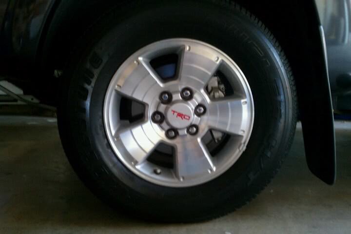

    Looks like I'm upsizing to 285/70/17...still deciding on which tire and trying to stay under $200. Gonna get TRD Center Caps for this look (just borrowed this from another TW member)...
