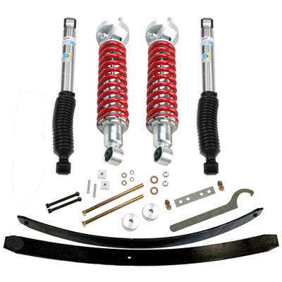

    So I've got the money now for a suspension system and narrowed it to two. I've read through a ton of threads and that's how I got to these two choices.
    My use is mainly daily driver, occasional trail rider and hauler.
    I'll be adding Timbrens to either setup to save the leaf pack from the heavier hauls and a 1/4" spacer for taco lean. Will need to save for LR UCAs.
    Let me know which one you guys would pick or if there are others kits in the same price range.
    1. ToyTec Ultimate $1,149 - http://www.toyteclifts.com/index.ph...ategory_id=64&option=com_virtuemart&Itemid=53
    2. OME NitroCharger $1,015 - $791 Old Man Emu NitroCharger Suspension Systems - Old Man Emu Nitrocharger Shock Absorbershttp://www.autoanything.com/suspension-systems/73A5935A0A0.aspx or http://www.trdparts4u.com/Scripts/prodView.asp?idproduct=-8415 - Thanks mpleitez
    Personally I am leaning towards the Leaf Pack plus NitroChargers.

    It comes down to adjustability of toytec front coilovers vs beefier leafs & shocks with OME.

    Good point Steve. I'm thinking the leaf pack is a clincher, both should put me around 2 to 2.5" I believe.
