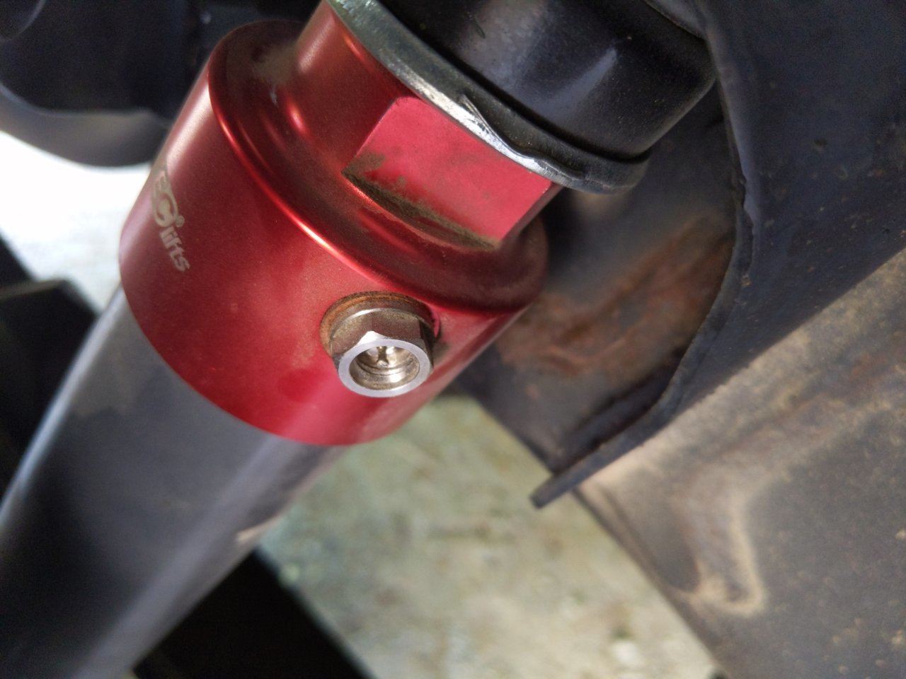

    What is this for? I'm assuming air? If so how much PSI does it require? Can't find anything on it. (BOSS ALUMA 2.0 BOSS Toytech Suspension Lift 2")

    Leave it alone.

    I doubt it’s air, most likely nitrogen

    Was completely empty. Had to put air in it bc it wasn't charged at all. Don't know if toytech forgot this one or what..but it fixed my issue

    Just be aware that the air will be affected by temperature and will ride differently almost constantly based on ambient temperature and however much the shock moves

    Air has enough impurities that it might cause corrosion internally. And will react more to temperature variances caused by using the shocks.
    Did you buy them new empty? If so call Toytec and get them warrantied.
    Did you buy them new and now they are empty? Probably have a damaged seal and they need to be rebuilt.
    Did you buy them used? They needed to be rebuilt and the seller pawned them off on an uneducated buyer that thought they were getting a deal.

    Welp, it's better than 0 PSI

    They are 6 days brand new. So I will be calling toytech. This is a band aid for now until they open Monday

    So is jamming tissue paper in a gunshot wound but it's not the best way to fix a problem. Depending on how long it's been like that it might already be toast.

    How are they that grimy and rusty at 6 days brand new?

    Just dirt haha. Maybe the washer is but idk what to tell ya. They're brand new. Installed last weekend

    That looks a lot like rust on the inside of that pressure fitting. And why does the dirt on the red cap look so greasy?

    Not sure what to tell ya. It's how I got them. My main concern is, is there a leak of some sort? So I'll have to monitor it until I can talk with Toytech on Monday

    And you were OK with your shiny new red shocks being rusty out of the box?
    Running shocks that you know aren't right are a great way to get any warranty that might have existed to disappear.

    Welp, well see what Toytech has to say. Appreciate all the help

    That’s an F connector for coax. Should get some good reception off that thing.
