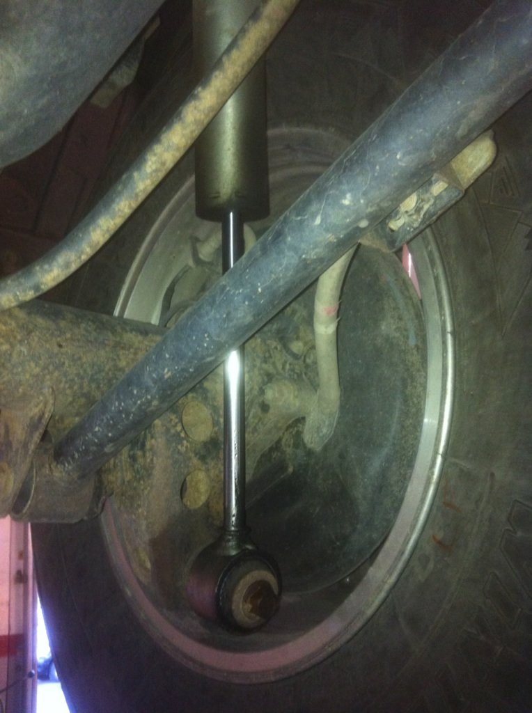

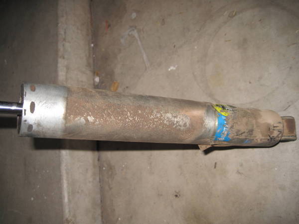

    Yes, I have taken the shock off and cycled it and it cycles as it should. My bitch and complaint is that the shock continues to leak oil.
    This is now my 3rd time taking the shock off, cycling it, and cleaning all the leaking oil off the body. A shock that works correctly and has no issues should not be leaking the amount of oil this supposedly "good" shock has and continues to. Cut zip tie off dust boot to show the continued leakage
    As with the prior 2 times taking the shock off, I again cleaned all the dirt and oil off the shock body and within probably a week or so there will be oil leakage all down the body of the shock again :mad:
