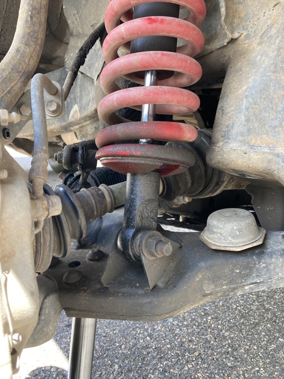

    I had a brand new pair of Toytec Boss Aluma 2.0 coilovers installed on my 02 Tacoma along with a diff drop and SPC adjustable upper control arms in March 2022. Now, just over 5k miles and 13 months later, my front right is leaking and Toytec says they won't replace it because we're past the 1 year warranty!
    I've heard nothing but praise for Toytec on TW and am curious if anyone else has dealt with a similar situation and has any advice on how to proceed. They suggested I pay to have the shock rebuilt (without offering a discount), leaving me feeling incredibly frustrated and disappointed with Toytec.

    We’ll that stinks for sure. When did it start leaking? From the looks of it, it was before the one year mark. Or did it blow out on the trail? I’ll assume you didn’t notice because you don’t drive the truck much.

    Fox shocks have a year warranty. King Shocks has 90 day. Pretty standard.
    I've had a shock blow on the second run. Ordered a seal kit, new shaft, some shock oil, and rebuilt it myself. It's not rocket math. Get it done boss.

    I had an issue with the shafts pitting and leaking oil that way. Same response from them, but they did loan me a pair of shocks while they did the rebuild so I could still use the truck. Overall I think they take care of customers, but sometimes shit happens. Sucks on timing, but not much to do about it except get them re built, or pay a lot more for a new shock.

    Thanks for the replies on this post! To answer one question @gotoman1969 I have no idea when it started leaking, though I agree it was well before the 1 year mark since there's significant build up on all the components surrounding the shock (and no leak or buildup on the left side for comparison). I didn't think to inspect the shocks within the first year since the truck isn't a daily driver and the off roading I do is moderate difficulty. Just for my own knowledge, shouldn't a shock be able to completely compress on trail without becoming damaged or leaking? I would have thought that there's a point where the shock stops performing and becomes a rigid member of the suspension without being structurally compromised.

    Yes it should, I doubt that is your problem. It is probably just a bad seal.
    It could happen to anyone. For example when overland outfitters did the blind shock testing, they had one of the kings leaking just after one day of use.....
    Or,(you should check) your shaft could have gotten damaged and it could have damaged the bottom seal... Hard to say until your take it apart id say.

    It should be able to fully compress(not bottom out) and fully extend( not over extend) and cause no damage to seals. As @05 4x4 said probably just a bad seal.
