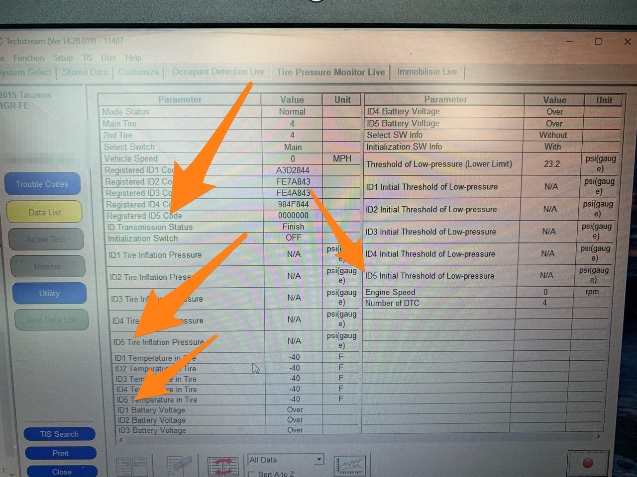

    I’ve read that the 2nd gen only works with 4 TPMS sensors, but Techstream is showing the availability for a 5th…
    Any one know for sure if a 5th can be programmed in and used? I have a full size spare that is part of my 5-wheel rotations.

    That's the issue... I don't yet. The OEM TPMS sensors went with a set of wheels I sold, so as part of prepping for new ones, I'm trying to figure out if I should order 4 or 5.

    Every toyota model shows 5 sensors like this, id code 0000000 basically tells it to ignore it.
    I've never had a customer request a 5th sensor, personally I hate TPMS and I wouldnt want my spare to trigger it even though its handy to know.
    The problem is programming with techstream only allows for 4 sensors, it won't ask for the 5th. You'd have to attempt to program using an aftermarket tool, most tools you can always select the 5th.

    Welp, with my 2015 TRD OffRoad, I was only able to program 4 sensors with Techstream.
    It would not let me use the same ID, so you can't program all 4 to be 0000000.
    So in summary, with Techstream V14, you can only program 4 sensors and they have to be unique alphanumeric values of 7-characters.
    For my 5-wheel rotations, I would need to keep track of the IDs associated with each wheel and then at each rotation, update Techstream to remove the sensor ID that has become the spare and replace it with the sensor ID that was the spare. Not too annoying, but good to know.

    Yep, that seems to be the case. During the programming, you would just input the 3 remaining functional sensors and then for the non-functional one, just type in `0000000`.

    I found another thread that shows a screenshot confirming my assumption...
    If your truck supports 5 TPMS sensors, the ID Registration wizard will let you input 5 sensor IDs.
    My 2015 only supports 4, so I can only input 4.
    Example of earlier Taco that supports 5 TPMS sensors: See "Total Tires: 5"
