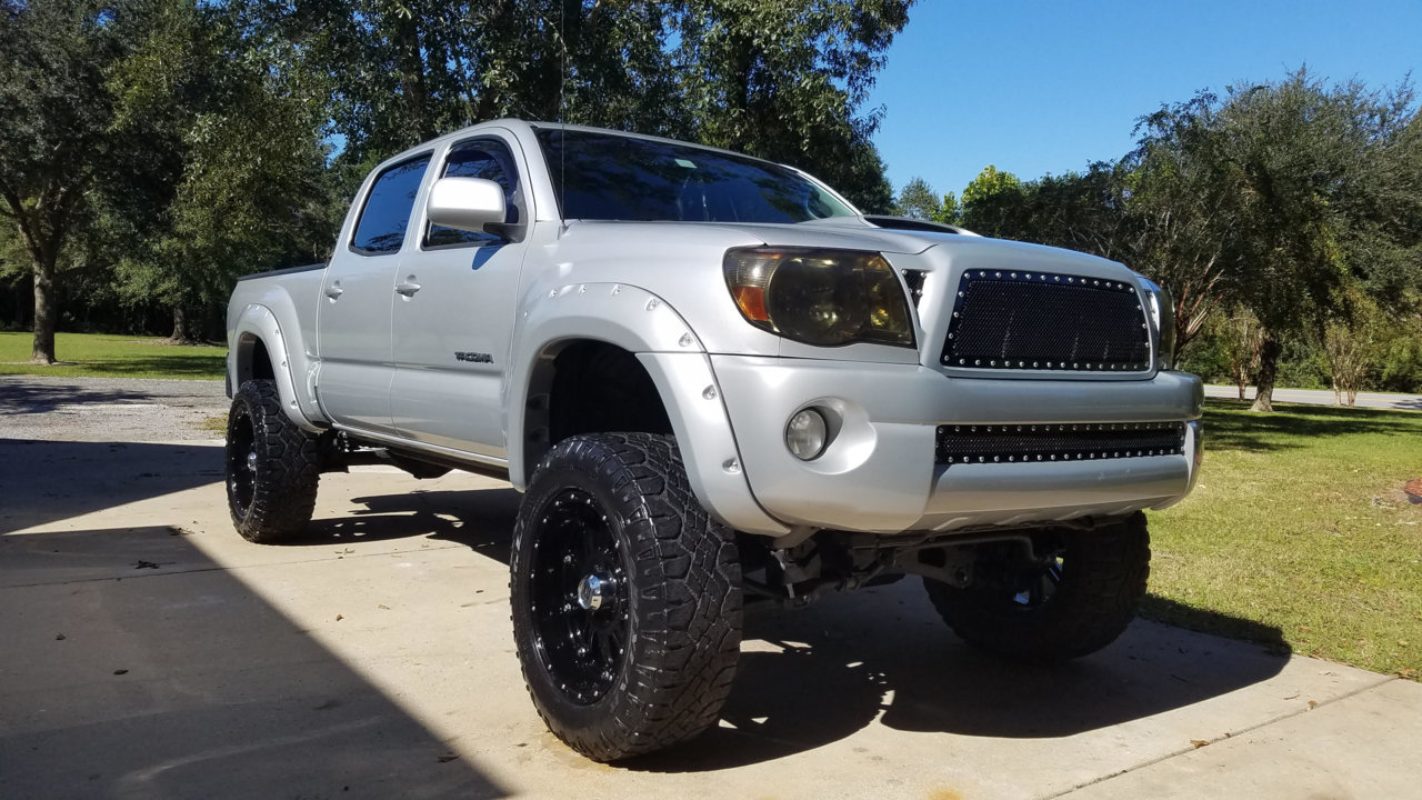

    Hello my Tacoma friends. I am needing some advice on replacing my old TPMS on my 2007 Batteries have been gone on my existing ones for a while now. I will have to replace my tires soon and want to replace the tpms at the same time. however looking on rock auto I am a little unsure what i need. There are steel and alloy options. screw on and clamp on options. etc..
    Also I see there is also separate hardware available for purchase. I have after market 20" rims and want to be sure I get the correct application and hardware for the install when the tires are installed.
    Not even sure if the spare has a tpms in it or not on the 2007.
