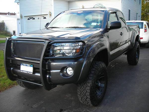

    Any way if i getthese photos in ok you will see the wheels I bought from Indycross ,Thank you once again, the tire , and my modest lil red taco.

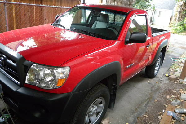

    Man i need to clean my carport then get a shot in the open, poor taco deserves a better shot.
