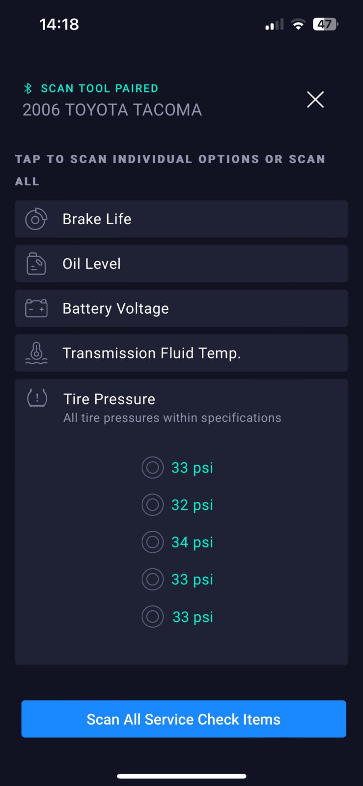

    Have you checked the codes in the TPMS?

    Not yet, thanks for posting the instructions. Need to find some time to test that out
