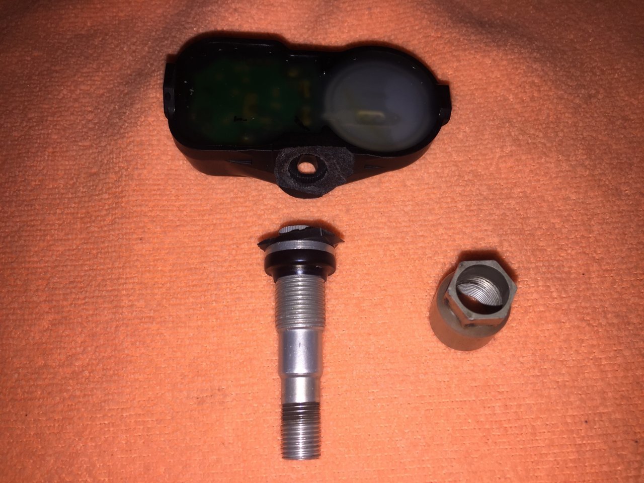

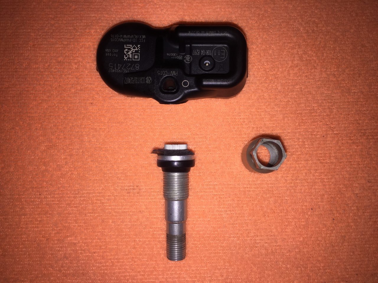

    Here is the sensor
    The manager said when his mechanic took the tire off the rim the sensor was floating around in there... I let him know that I was sure the sensor was not broken when I brought it in but he insisted it was and was just flying loose in there for god knows how long. I figured it might be a little marked up if that were the case... He said the sensor would still work if it was loose in there and could have broke off when the tire went down. I told him that tire hasn't been past 27lbs of pressure since I've owned the truck (original tires too)… But he said he would replace it at no charge and I told him that I was informed it needed to be a Toyota OEM and he had no problem with that. So all in all, I'm glad they are doing the right thing. They will continue to get my business and referrals if this turns out..

    Lol, yeah, his tech did that and didnt want to fess up to it. Those dont just break like that. Look at the body of the sensor, there are no scuffs, rubs, or anything to show its been bouncing around the tire...
    glad they took care of it though
