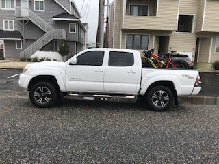

    Thanks for all the quick replies. I do have a sensor in the spare and when I swapped the new tires on I was hopeful those sensors would work. However, I believe Steelcity2 is correct so that will be that route. Here is a pic. I've made a few mods: upgraded stereo, hood struts, Bilstein 5100 (when the frame was replaced - thanks Toyota), Satoshi Grill (by Homer's Grills), OEM LED tail lights, headlight cable upgrade, etc. The truck has 155K miles and it's barely needed anything besides the expected wear items.
    Thanks again for all the feedback.

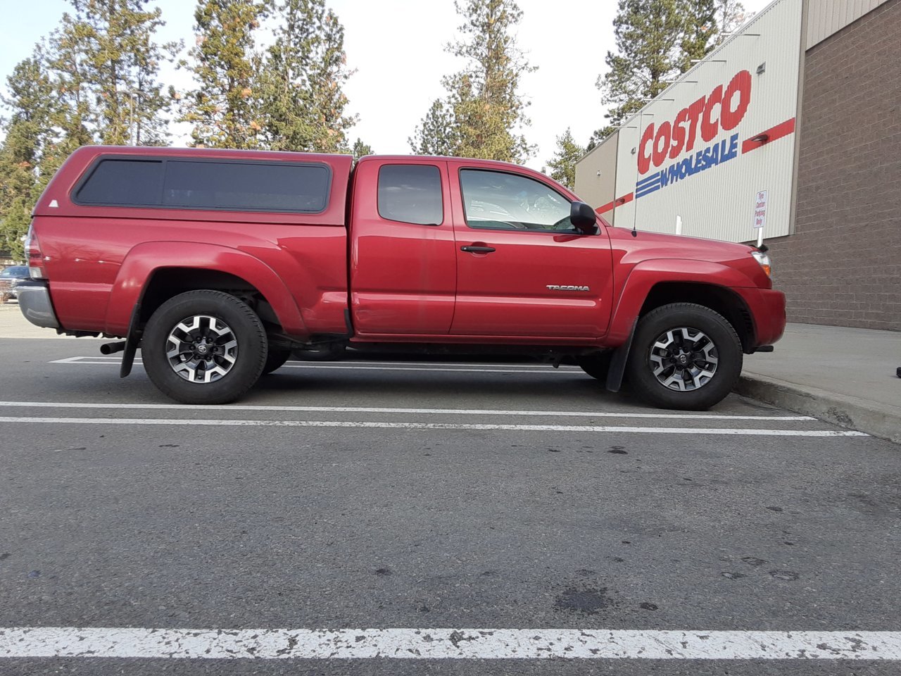

    The 2018 Toyota charcoal alloy spare and the original steel spare wheels did not have TPMS sensors, just the rubber valve stems. The TPMS sensors for the new Gen3 alloys wrere purchased from an eBay Motors store, as were the wheels and black OEM lug nuts, total for the entire kit $772.69 (including sales taxes and shipping).
    My Costco Tire friends installed the new wheels as a "winter tire swap" at $49.96 (8 wheels/4 tires vs. 8 tires/4 wheels same-same). The TPMS were programmed by the seller for 2008-2012 Tacoma OBDII, and Mike went around the truck twice and reported they all read into the system. I'm pleased with the new look. 20220202_105853[1].jpgThe spare is tucked up under the bed, and I usually exercise the crank hoist mechanism annually so plan to check air pressure at that time. (I discovered with my new 1984 Longbed Deluxe that the chain hoist did need to be exercised with the first time I got it unstuck. The much newer truck uses a wire rope hoist.) (Photo was taken on Groundhog Day while admiring the installation.)
