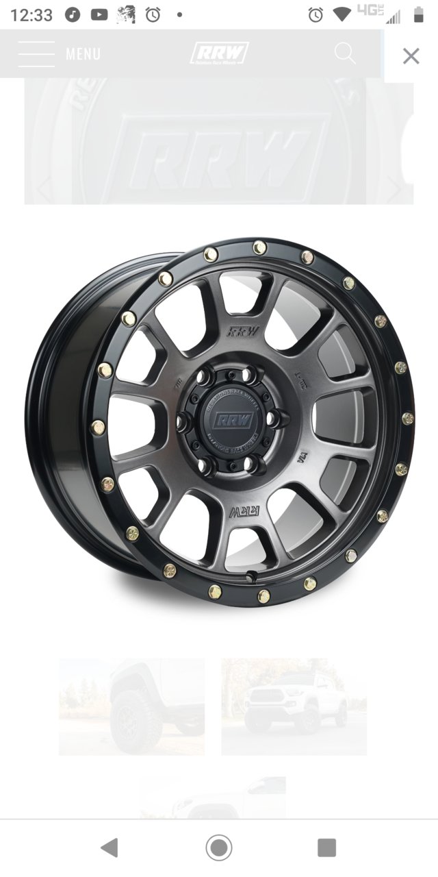

    Im Im installing new wheels on my truck! I notice when i put air in the tire the valve got stuck open! Is there a rebuild kit for the tpms or what's a good replacement?Screenshot_20191225-123319.jpg

    Wonder if they make these in a 5 lug? :spending:

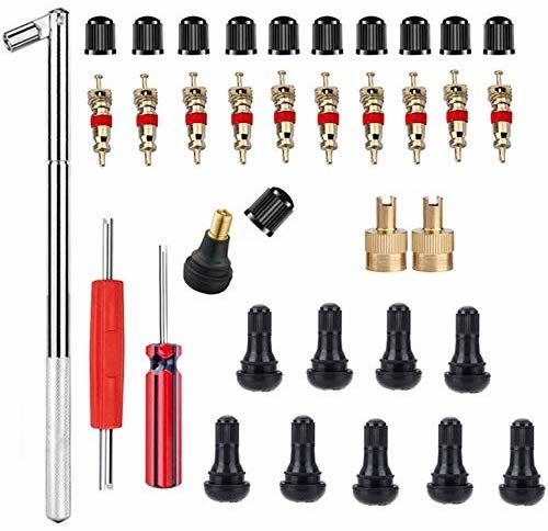

    The rebuild is a new o-ring/gasket where the TPMS mounts into the rim around the base (see post 4 pic and notice the black gasket. Remember replacing with new TPMS as in post 4 have to be programmed into the ECU and old one (s) removed from program so tire store will charge you. Usually batteries last 7-10 years so 2015 should not need them.
    If air is leaking out the actual end of the valve stem where you add air see if the valve stem cores are screwed in. Here is an example pic just look at the cores as old style valve stems.

    I was just checking about a rebuild kit! I been searching for one but toyota sells the mounting and gasket hardware! I was needing to replace the cores if i could

    Go to any auto store such as Advance range from $7-20.
    I never had one go bad so no advice on quality.

    I see no need for a rebuild kit, seals & gaskets should last way longer than the batt. As yet Haven't had a leaking valve core, but don't see the TPMS using anything other than plain old cores. Please let us know what you find. Also just looked on ebay, the cores are appx. $5.00 for a hundred (per 100) of them. Good luck.

    Just go to your local tire store and ask if you can get a valve core.. they buy them in bulk so they’ll probably just hand you one.. when I was working in a tire store valve cores can become loose and leak.. just be careful not to strip the valve core or you’ll be buying a new sensor.
