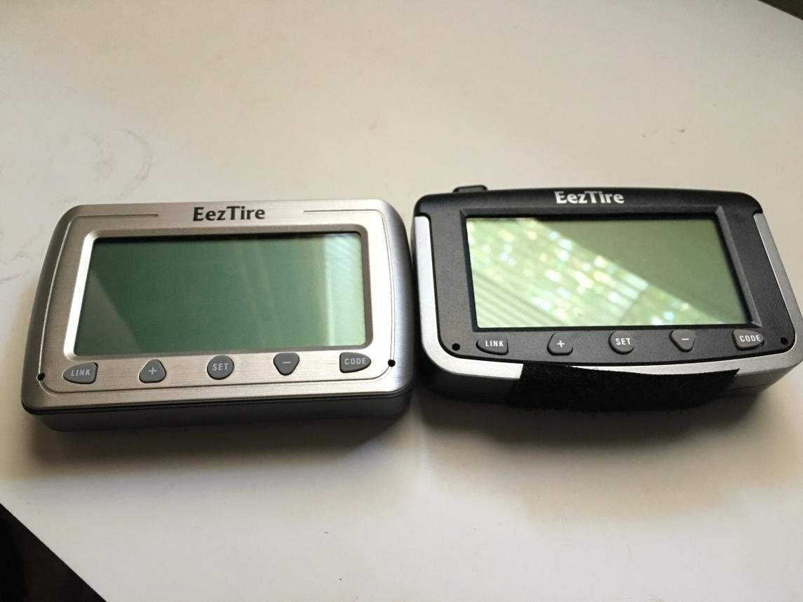

    https://eezrvproducts.com/shop/ols/products/eeztire-tpms-system-monitor-only-color-eez-rv-tpmsmonc
    Thats the one I've been using on my Tundra. Then I bought the same one for the Tacoma. A lot of people with RVs or trailers use this brand. I've tried the cheap Amazon ones $25-$50 two times in the past, ended up throwing them away. They would lose connection to the monitor and you would never be able to resync the sensors again. No option to sync. Rendering one of the sensors useless. I've been using the same unit on my Tundra since 2015...I am too lazy to manually check the tires often, real time TPMS is a must for me on all my vehicles.
