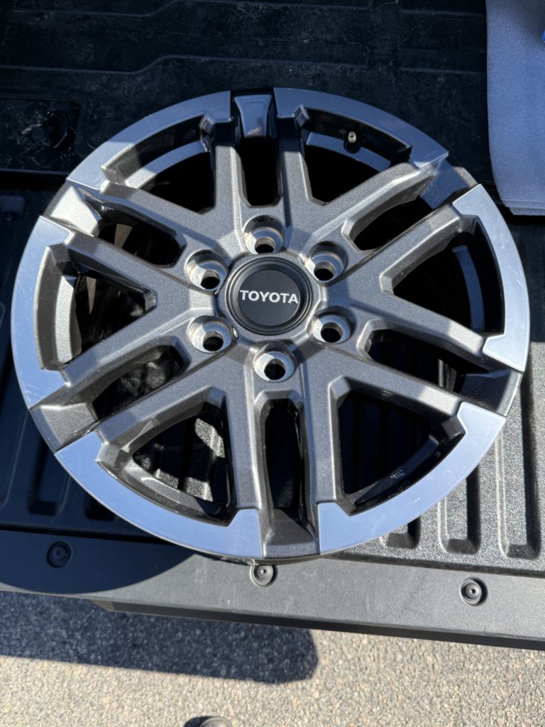

    Hey folks.
    I picked up some brand new boxed OEM 18" TRD wheels on marketplace this week and I'm about to pull the trigger on a tire upgrade for my SR5 (leaning toward BFG Trail-Terrains). Swapping out the red TRD center caps for some heritage caps for a more classic look on my SR5.
    The wheels did not come with TPMS. Two regional tire chains here in Boston can install and program aftermarket sensors along w ith the tires. One place wants $80/sensor plus a $120 programming charge, which seemed pricey. The other place (Town Fair Tire) is asking $30/sensor and no programming charge. I didn't get the brands of sensor from either place - I probably should.
    Are there any issues with aftermarket sensors? Are any brands better or worse? Anything to be aware of?
    I imagine all the sensors in all vehicle brands are outsourced by the manufacturers. I tried to search the forum and, honestly, ended up confused as hell.
    Thanks!

    Town Fair are good peeps. Call and ask if they are Bartec. They are the most reputable and common TPMS supplier, and software provider to tire stores. No need to pay such a high price for TPMS sensors.

    Thanks! They are Bartec. I'm going with Town Fair and a set of BFG Trail-Terrain TAs.
