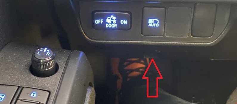

  4. Nov 30, 2020 at 4:04 AM
    oyemengitsamie
    oyemengitsamie [OP] amie.
    Mar 16, 2016
    #181449
    950
    Gainesville, FL
    2020 Toyota Tacoma SR V6 4x4 in MGM

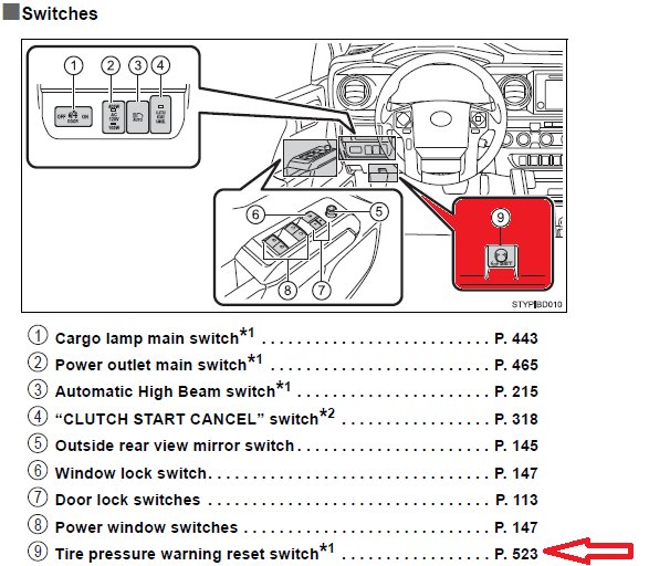

  5. Nov 30, 2020 at 4:14 AM
    caribe makaira
    caribe makaira Well-Known Member
    Feb 13, 2011
    #51121
    11,786
    Caribbean, Puerto Rico
    05 PreRunner TRD Offroad AutoTrans
    Hood Struts, My version Fogs always ON, Map & Overhead Light Mod,

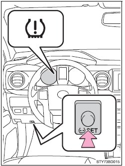

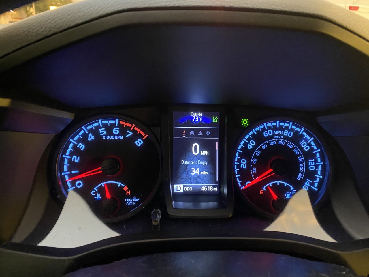

    Is there a button there? Kinda dark pic.
    Also, without starting the engine, placing the key to ON, see ALL the lights...
    Taco_Coma and jmneill like this.

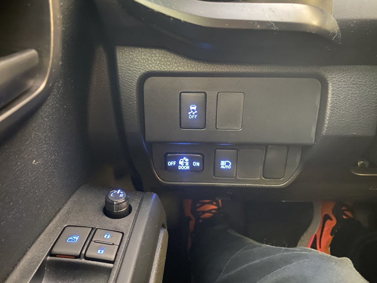

    Scroll over on your screen, should show you. What wheels do you have currently
  7. Nov 30, 2020 at 4:15 AM
    oyemengitsamie
    Mar 16, 2016
    #181449
    950
    Gainesville, FL
    yes! I found the button! it’s super hidden lol

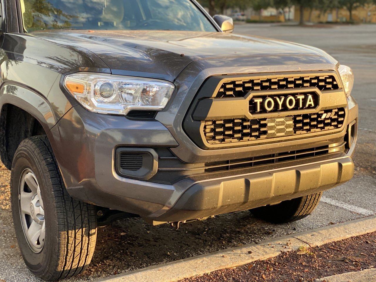

    gross steelies :(

    You might need different sensors depending on the wheels. Sometimes they can make them work, the angle is different on those steelies I believe

    No! Shipmate the steel wheels have different sensors. Steelies have 40 degree sensors vs 20 degree sensors that are standard for alloy. You can get them to fit by mounting them upside down, but you will likely break them and could have signal issues.
    Best to buy new and get them programmed. More cost, but worth it in the long run.
