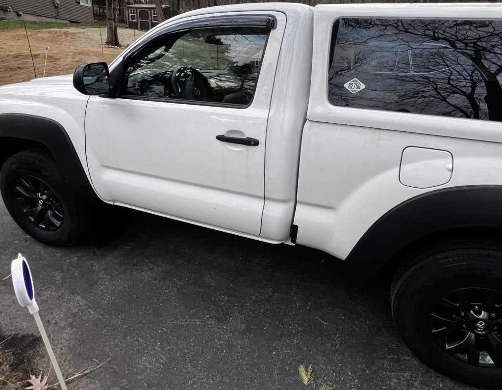

    I recently picked up some used 3rd-gen Tacoma rims and tires, I'm running them at 40 psi compared to when I was running about 32 psi. I believe the TPS is connected to my truck, but now my tire pressure light is on, saying that the tires have too much air. Is there a way to reprogram them?
    (photo for attention)

    3rd gen sensors won't work on 2nd gen trucks, you have to use your original sensors or get the sensors for your truck and have them programmed.
    The pressure threshold reset button is on the knee bolster under the steering column.
