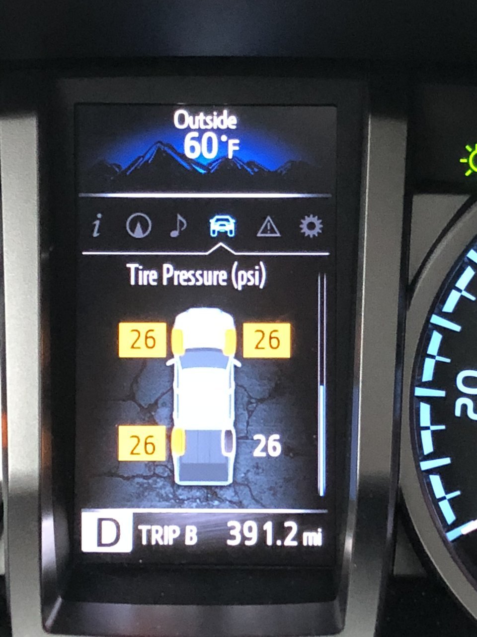

    Started my taco today (4,800 miles) an it had the tire pressure light on. TPMS shows all tires at same psi but only 3 of them are lit up orange. After driving while, the back two both changed to 27 psi but that back left still stayed lit up. I believe cold psi target is 29. Just wondering why not all lights would be on if tires are same psi and if the tires should be so low after only driving less than 5k miles. Thanks.

    Yes the 5k appointment is worth it. Theyll rotate your tires and fix that bad tpms sensor if its broke.

    The threshold isn't a fixed value. Each tire has it's own. You can see it in Techstream. Not sure if it's based on a percentage when the learn procedure is started or not.

    26 or even 29 psi ? What tires you running ?

    stock on a limited. door jam says cold tire psi target is 29.

    Honestly maybe it's just me but isn't that to low? I would inflate to 30 maybe 32 to be safe then hold that tpms reset button under the driver kick panel and drive it until you numbers show up again.
