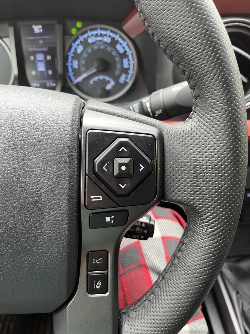

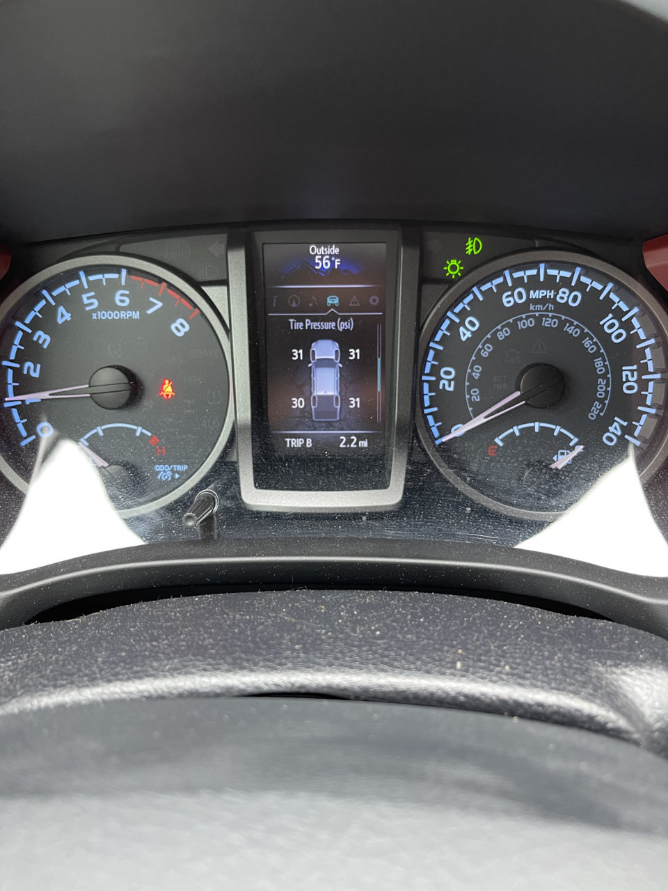

    You should be able to check numbers. The directional arrows right and left on the steering wheel should change what screen you see on your gauge dash. One is tire pressure.

    I don't know what all these gizmos are you're showing me. ;) My truck is 2011 base model, crank windows, manual locks, etc. No buttons on the steering wheel, no LCD screens. I like it, but I was shocked anyone produced such simplistic vehicles in the 2000's.

    Fuck sorry I didn’t realize it was 2nd gen. If you are within 33-35 take it to the shop that installed the TPMS and make sure they fix it.
