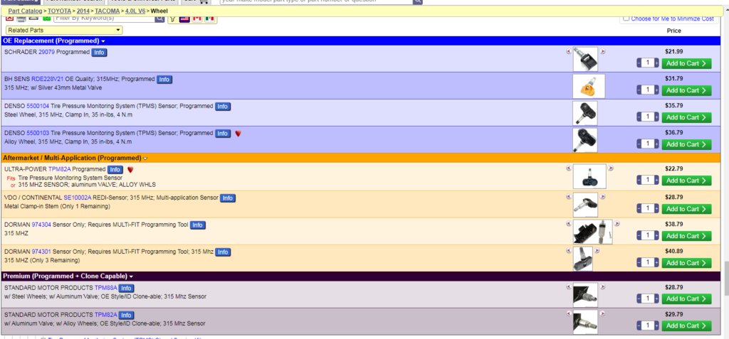

    As I recall, the Toyota TPMS sensors are supplied by Denso and are manufactured by Pacific Industries. Save yourself some loot and get the Denso sensors for around $37 ea.. Know that the alloy and steel wheels use different sensors. The last of my original sensors failed at 12 years. It still works but leaks a slight bit.For me it's not worth just replacing the rubber seal.

    Do you have any more info on the different sensors?
    I swapped from steel to aluminum wheels and discount tire moved my tires and tpms sensors over, everything works fine.

    It's not clear but I think one has a slight angle and the other is straight, definitely 2 different part numbers.

    As stated, the angle is different between the two and it's obviously doable but when the tires are removed down the road they might be be damaged by an installer who isn't aware of the issue. This is from what I've read and not from practical experience.
