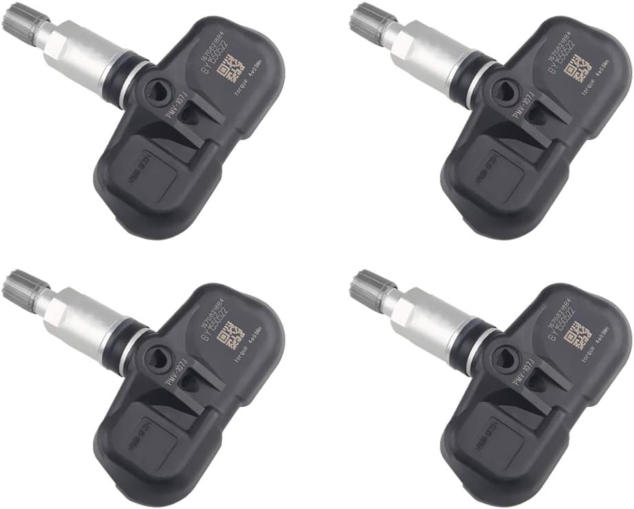

    What's the current fix for this?
    I hear the batteries can die after 10 years.
    Just got a warning light but tire pressures are normal. Already tried a reset and drive.
    Am thinking of stopping by Costco to see about having it checked with their $1k tpms scan tool. They hold it up to each sensor for a minute and it knows if it's dead (battery) or not, aka in need of replacement.
    They say on the back pmv-107j, which Amazon has some kits claiming to fit for $50
    has hit or miss reviews though, some people unable to sync them no matter what.
    Not sure if that makes it worth it to try and narrow down which sensor is bad to pay dealer part cost for one ($60?)
    Any more than that does not seem very in the spirit of Tacoma-like. AKA "I own simple rugged DIY cheap truck and DIY chopping wood in wilderness except tomorrow going to dealership paying man $250 to scratch balls"

    Batteries can vary. I've seen them die after 6-7 years and the ones on my almost 14 year old Tacoma were still working when I replaced them. I ordered new ones from Amazon at about $20 each. When I had new tires installed in March the tire store installed the new sensors and programed them at no extra cost. Like I said, mine were still working, but after 14 years I knew they didn't have long.
    If you buy them and have them installed without buying new tires expect to pay $10-$15 each for a tire store to break down the tire, replace the sensor and remount them. If you're going to need new tires soon I'd just wait and save a little money on instillation. Spending $80 every 10 years isn't a deal killer and worth the trouble.
    These fit my truck. You'll just have to plug in the numbers to find what fits yours.
    Amazon.com: MOBILETRON Tire Pressure Monitoring Sensor (TPMS) for Lexus, Toyota (TX-S008), 315MHz, Set of 4: Automotive

    My factory TPMS batteries died after 11 years. Got them all replaced for about $250, now good for another 10 years most likely.
    Keep in mind that the sensor in the spare tire may be a different part than the other 4 due to the design of the wheel. So stupid :censored:

    my spare tire TPMS looked the same from what I remember, when replacing the service pack to swap the spare steel wheel
    honestly the only thing I was worried about was a compatible part that can be programmed, that is hopefully affordable
    breaking down a tire to install one is the quick and easy part
    breaking down the tire or not, if it is taken off/deseated from the rim to swap in a new TPMS that ends up being crappy and not programmable, then that becomes waste of cost/time
