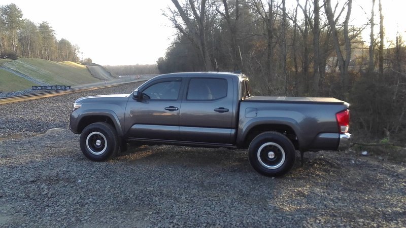

    No issues used my stock tpms and pushed the reset button next to the hood latch and works greatIMG_20160229_073426.jpg
