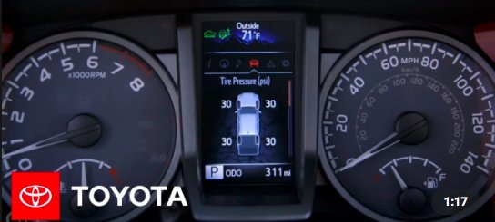

    Its better than that! It goes orange for mid range pressures, and you can keep an eye on them when offroading.
    I love that feature personally.

    So the TPMS system is regulated for safety and fuel economy, so you can't really modify its threshold lower. That light will always come on. It's supposed to.
    I had a 2016 model, I'm not 100% sure if the new models do the orange still. But I liked how Toyota acknowledged it's not dangerous but a concern.
    I like most of us on here like data and feedback. It's just nice to keep an eye on the pressure during breaks without having to get out of the truck.

    This is my go-to screen so that I can always keep an eye on them, for best tire life. Wether I air down or up.

    My first time airing down I overshot my target of 20psi and ended up at 14-15psi in each tire. I was a little concerned with it being my first time airing down and driving over rough rocky terrain that I'd pop a bead at that pressure. So I kept the tire pressure screen up on the display the whole time checking it every so often to make sure the pressures didn't get any lower. Using that screen was reassuring for me.
