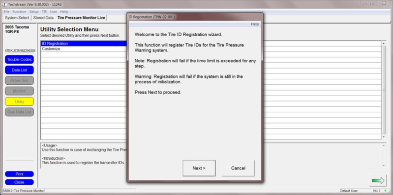

    You can do it yourself, without needing the ATEQ, by purchasing an OBDII cable and download free Toyota Techstream software, all for around $25 total.
    https://www.tacomaworld.com/threads/setup-tpms-sensors-cheaply-using-tis.397820

  18. Dec 23, 2015 at 11:27 AM
    #218
    Crom
    Crom Super-Deluxe Member
    Jun 22, 2009
    #18782
    9,641
    Nick
    San Diego, CA
    2009 4x4 DCSB Camp Supreme
    Millions
    Thank you so much Tomwil. I will file that for future reference. I got new tires earlier this year and debated purchasing new sensors (6.5 years old). I decided to keep my existing sensors until the batteries quit.
