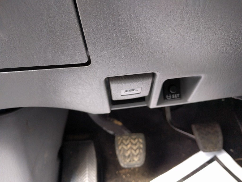

    Hmm... I bought my 2014 TRD Sport 6 Speed last week, and I am trying to learn about it...
    I assumed that this button was used to reset the TPMS sensors:
    If not, what is it there for? I am starting to make a plan for the day I need/want to replace my tires. I will be on the lookout for a set of used wheels and tires, and want to know which year's sensors will work with my Tacoma.

    It does reset them. As far as multiple wheel sets, you might want to look it up but I think you can only program two sets of wheels.

    Oh, so the existing wheel sensors have already been paired with the truck... am I am correct in assuming that the computer will only accept one set of paired sensors at a time, which is why everyone has to go through this fun when switching out wheels?

    Pretty much. You might want to check whether your truck can have one or two sets of TPMS sensors programmed.

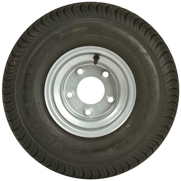

    A small trailer tire may be a good, easy choice. An 8" wheel with tire is small and you can put the sensors inside with room to spare.
