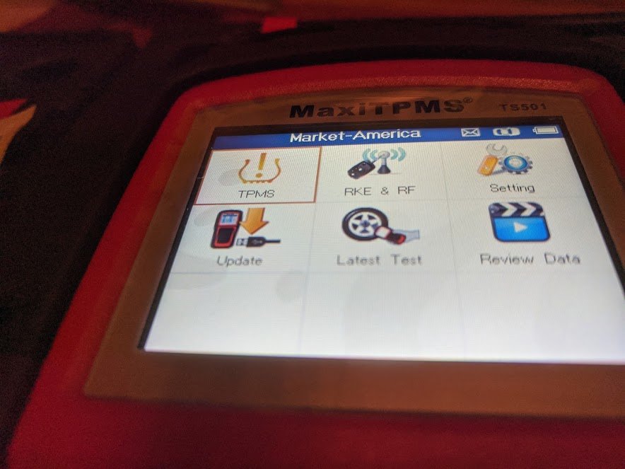

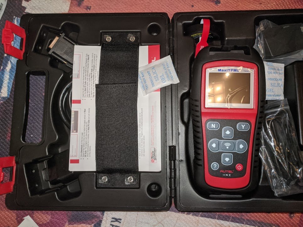

    Talked a little about this on a different TPMS thread. The answer to all TPMS problems is to own the tool. Bought the scan tool and 4 sensors for $300 (sensors were $25 each). The Autel sensors are duel frequency 315 & 433MHz which cover most everything out there.
    My 17 SR5 is 315. I scanned my factory sensors the put the new sensor in the pocket at the end on the tool. I told it to make those 4 the same position as what was on the truck (right front, left front ect). I then told my tire guy to write on the new tire the position as he installed each TPMS. Once the new tires were on the truck, I plugged into the ecm and told the truck to accept the new TPM sensors. DONE!
