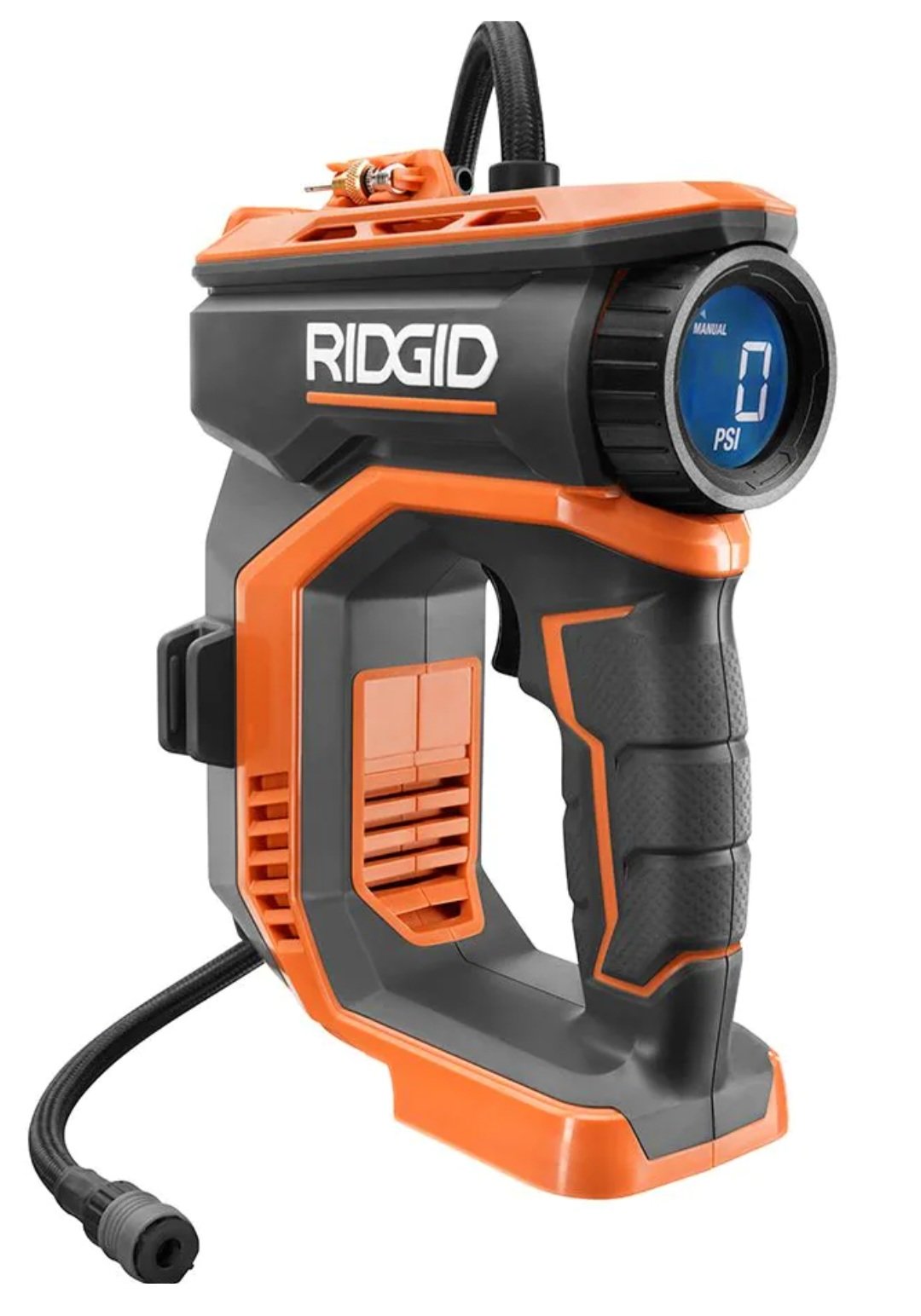

    I use the Ridgid Inflator with the Autel TS508. Connect to valve shows pressure. Dial desired pressure and press trigger. It runs high speed until it get close then stops automatically.
