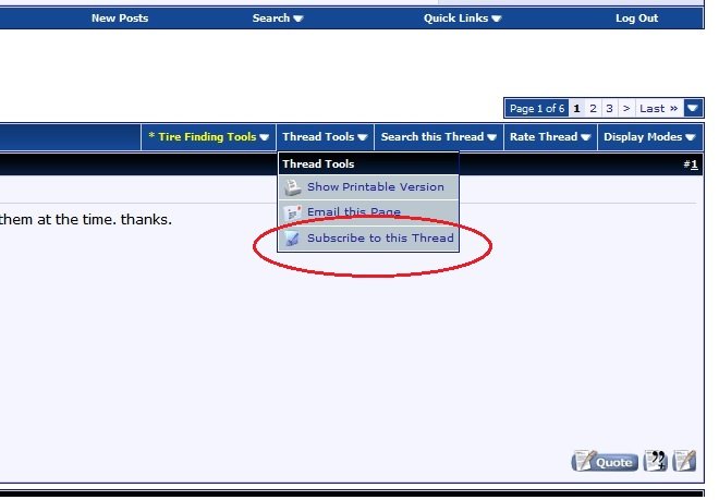

    Means you have subscribed to the thread, so you will be alerted to any comments, posts or pic's on that thread...Kinda' cool huh..!!

    Means you wanted to add the thread to your subscription list but also felt the need to announce to everyone in the thread that you are watching when you could just as easily have used this....
    techbill likes this.
