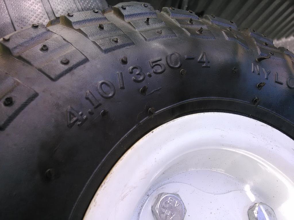

    To remedy your TPMS light issues, from not having the sensors installed... This is a $6 fix in takes 5-10 min.
    Go to Harbor Freight and buy this wheel/tire:
    Haul-Master - 10 in. Pneumatic Tire with White Hub - 30900 Deflate the tire
    Unbolt the (2) halves of the wheel
    Insert the TPMS sensors between tube and the tire's sidewall
    -make sure the sensor side (soft side) is against the tube
    -make sure the casing side (soft side) is against the tire
    Reassemble wheel
    -make sure the sensor isn't touching wheel
    Inflate to desired psi...
    -Place behind or under seat in vehicle
    TPMS light should go off within moments
    -no harm to sensors or vehicle
    I had to do this because I upgraded from my original 16" steel wheels to my 16" TRD FJ Trail Teams wheels... there are seperate TPMS sensors for OEM steel and OEW aluminum wheels. The sensors are attached to the wheel at different angle. Similar issues may arise with aftermarket wheels. This is a way to turn the TPMS light off.
