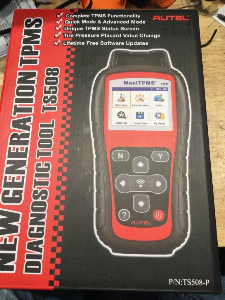

    Tire rack sensors are probably not programmable. Our Subaru got winter tires from Tire rack and they purchased the sensors from the Subaru dealer across the street. I ended up buying an Autel TS508 kit that came with the tool and 8 Autel MX programmable sensors. It cost me $272 at Advanced Auto (in 2020) but the sensors have to be worth $30-40 each and I used them on my 09 Tacoma and 23 Tacoma for the snow tires and rims I had purchased. After the Subaru dealer charged $65 when he quoted $40 to just relearn the positions I decided to buy the tool. The Tacomas I've had only have an idiot light and not the 4 pressures on the display (2023 had the full displayed pressures on the test drive but when the head unit was updated during delivery they disappeared. The SR is not supposed to have that feature). I cloned the OEM sensors so I don't need to relearn on the Tacomas. This model is easy to use. Don't know what the current price is for the tool alone.

    Truck #3 what year is your Tacoma? My 2023 SR that does not display individual pressures and has no feature on the head unit for adding a 2nd set of tires and sensors. Since my truck doesn't care what position a tire is in I can get away with using my Autel cloned sensors on the winter tires and not worry about resetting every winter and spring or when rotating. When I looked at the higher trim level features nobody said anything about a feature to add a second set. This sounds like something new and would be a welcome addition if it worked.

    You can do it yourself with a handheld programmer. Here’s the one I use.
