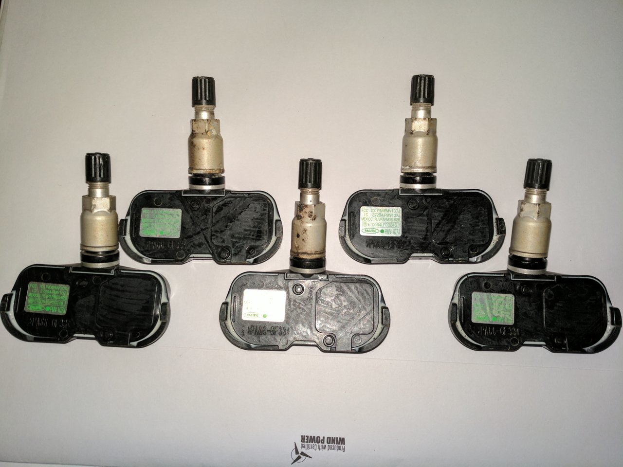

    The angle of the sensor in relationship to the valve stem is what's different between alloy wheel sensors and steel wheel sensors. Alloys are 20°, and steelies are 40°. Some people have been successful at rotating the 40° steel wheel sensors 180° and then the sensor is just not sitting flush against the wheel. From what I've heard, there is a chance they can be snapped off just putting the tire back on the wheel. Some guys say they're more prone to leak. I don't know anyone personally, it's just what I've read on here.
    I recently purchased 2 sets of 3rd Gen sensors off Ebay and had no issues programming them with an Autel TS508 tool. I paid less than $100 for both sets.
