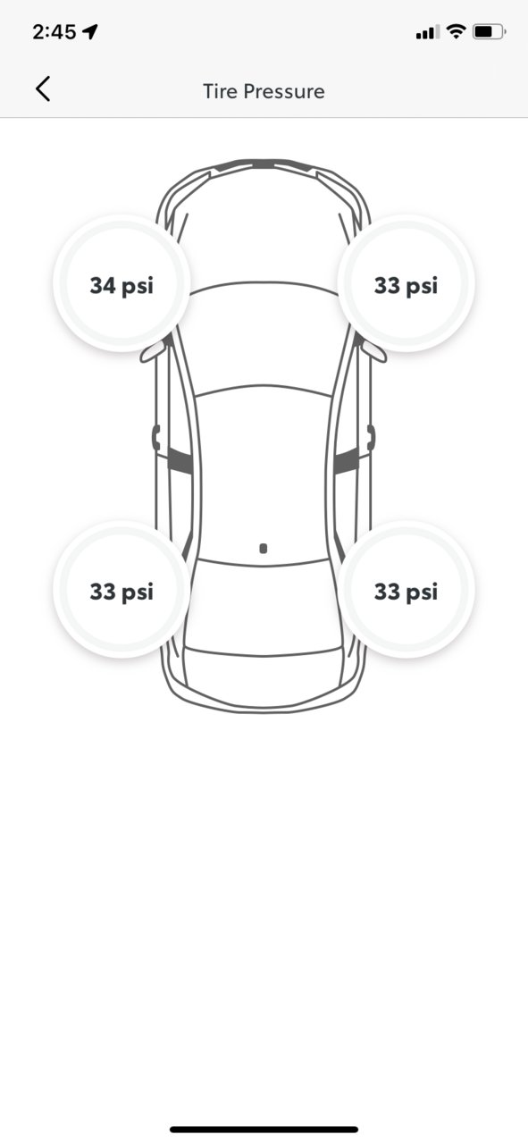

    I can comment on my 2021 SR 6cyl at least. I also can't (or don't know how if possible) view live tire pressure on my dash anywhere; I just get notified when it is low with no specific numbers shown. In the Toyota app I can see the actual individual tire pressure but they didn't make it super easy to find. I have to start by tapping the "My Garage" at the top of the screen then locating "Tire Pressure" under the "Maintenance" heading. Tapping on that reveals this:

    nice, thanks, I see that you rock those aftermarket wheels instead of the steelies, that means the alloy sensors will work with SR, I'll go that route too. Not being able to see individual pressure in the truck is not a big deal if the app can see. The low tire pressure light on the SR is just too insensitive to find a slow leak. I much prefer the individual exact read out, and if a tire is 3-5 psi lower, which won't trigger the low pressure warning, chances are there's a nail in it, and I can find it sooner

    Sure thing, happy to help. To be perfectly honest I'd been grumbling about not being able to see actual live PSI per tire a while now and didn't consider looking in the app until your post, so you've helped me resolve a source of aggravation myself. And yep, I got the Pacific OEM alloy TPMS and they've been great on my aftermarket wheels - no issues whatsoever.
    On the sensitivity issue, I had assumed the low tire pressure warning wasn't so much about sensing a precise amount of pressure escaping over time (a sensitivity issue) as much as notifying that a specific PSI threshold had been crossed, but I'm not certain. Here's why I thought this though; it has gotten colder recently and I'd been running all tires around 31 PSI, but the colder weather took them all to around 26 or so. This triggered the notification about low PSI. I aired back up to the above numbers and the warning goes away. There was another instance prior to airing them back up that I had an urgent place to be and simply drove on the tires starting at 26 PSI and the drive was long enough that (I presume) they warmed up and the PSI increased enough for the warning to go away. It returned the next cold morning though, which is why I just put them all around 35 or so.
