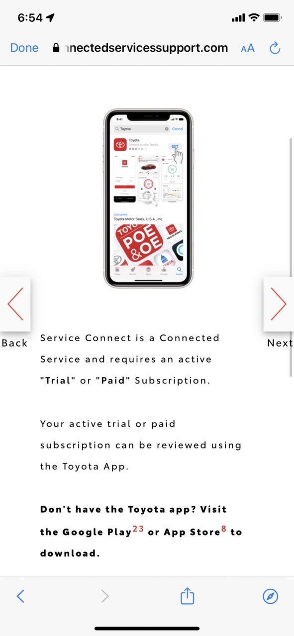

    Not that I know of, I will have to double check. As in my reply to Finn-2187 it says I have to enroll in AT&T wifi connect

    Hmm that's interesting. Looks like that service let's a person use their vehicle as a wifi hotspot. Digging around the Toyota app I think I have figured out the problem you are experiencing, but we'll see. So it looks like the vehicle diagnostic data (contained within the "Service Connect" Service) including TPMS can only be transmitted and displayed to us in the app while a paid or trial subscription is active. Wifi connect appears to be one of the paid/trial services that Toyota considers adequate to let us have this feature, but it also appears Safety Connect is adequate too. Basically I understand this to mean Toyota is saying "You gotta pay for that data one way or another". I think the reason I can see my data and you can't see yours is that I still have 16 days left on my first year of free Safety Connect, since I bought my truck almost a year ago. If you look in your subscriptions in the Toyota app I bet you don't have Safety Connect active - is that correct? Did you ever set it up when you first got your truck? If not, you may have a free year trial still, but I'm not sure if that's a "use it or lose it" year perhaps. If none of this helps I'd contact Toyota Connected Services and see what they say. Looks like you can do that through the app. I've attached a screenshot of the definitive info on which I'm basing my understanding. Good luck!

    No, Safety Connect is not active but a three month trial is available but I'm not going to mess with it. Thanks for your help, you cleared up the confusion!
