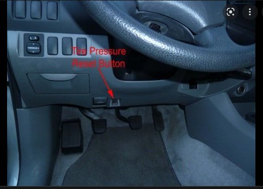

    Let me start with, I am not a total idiot. I have a '17 Tacoma SR 4x4 that I bought back in the winter, and I cannot get the TPMS to reset to save my life. I have read the manual and thought that I was following it's instructions. I have looked on YouTube and Google and not found any help. What do I have to do to make that light go away? I do not think that I have a smart key system or the multi function display.

    Tacospike. Thanks for the photo! Unfortunately, I know where the button is but the procedure for doing it seems to be beyond me.
