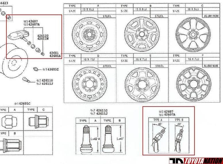

    toyota oem alloys are 20*
    toyota steel style (non black) are 40*
    you either use a rim band kit $50, build a tpms canister, a wheelbarrow tire, buy a rebuild kit from $toyota$ :eek:
    or pay for the tire shop to do the rebuild.
    Some say you can ask the tire shop to turn the sensor 180 degrees.
    alloys & styled steel rims do not mix even on the tundras. :(
    PTR38-34070-Kit
