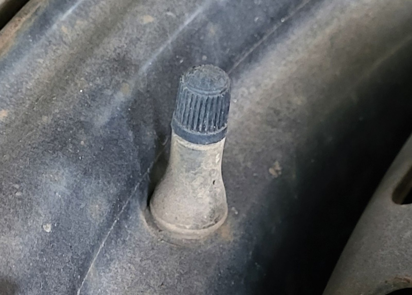

    I have a 2013 Tacoma. I checked the spare tire and I don't believe that it has a TPMS. Pic is attached for verification.
    My question......
    The previous owner removed all of the TPMS sensors long before I bought the truck. The low pressure light is on and I want to install TPMS sensors so that the light goes out and it becomes functional.
    I have found some sensors online at Amazon called MORESENSOR 315MHz Tire Sensors in a 4 pack for 49.99. If I get my local mechanic to install them, is he able to program them without me going to the dealership?

    Yes, a tire shop should be able to program them for you. I just got some new ones for my 2008 and my friend who owns the tire shop programmed them for me. The spare tire should have one to and the one in your picture doesn’t seem to have it.

    Not just any 315mhz sensor will work. You can use either OEM p/n 42607-04010 sensors or aftermarket sensors that are compatible with the same p/n I just provided.
    The 42607-04010 sensors are installed with a nut and washer but Toyota moved over to snap-in rubber stem sensors a few years later in production.
    The 2nd gen Tacoma never got TPMS in the spare.
    The Tacoma computer may or may not even have 5 storage values for 5 TPMS values like some other other Toyota models. If not 5, it will only have 4 for the 4 ground tire and wheel assemblies.

    Corrrect, the spare has no sensor. Just go to Discount Tire & get their own sensors installed.
    They'll be programmed correctly & you'll be good to go (or any tire place).

    Not on his '13. That ended sometime in '09 model year.

    '05 - sometime in the '09 model year did have a sensor in the spare.

    Your 2013 doesn't have one in the spare. My 2007 does, but I think they stopped doing that in 2008 or 2009.
