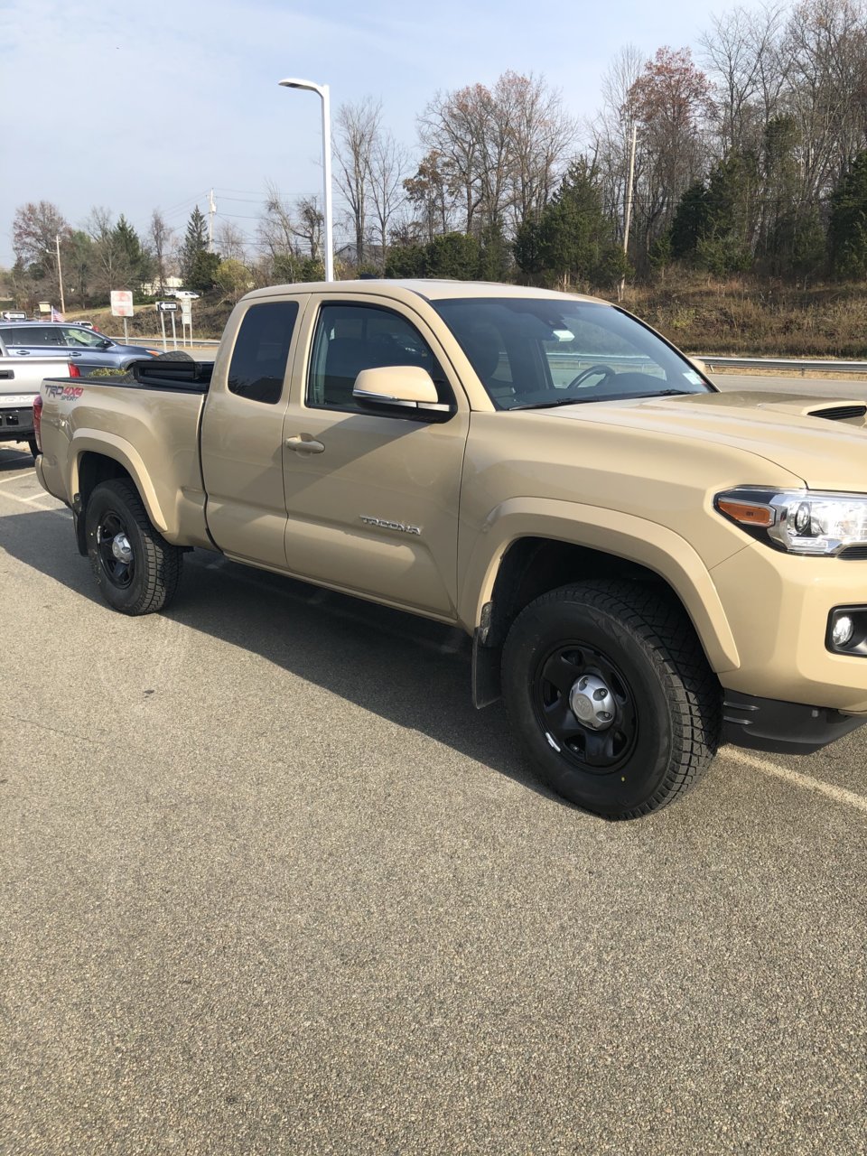

    Hi all,
    Back in August I picked up an extra set of wheels for my '18 TRD Sport, my intention being to designate them for snow tires. They are off of a '15 Tacoma. I sanded and painted them, with the help of my father-in-law, and I was planning on powder coating them next summer. I got them for free off of Craig's List, a really nice guy was selling them for $100 and when he found out it was for a Tacoma he gave me the Tacoma Discount, which was very kind.
    Now for the issue: they have TPMS sensors, but when I had the tires mounted and installed, the dealer was unable to connect the sensors to my truck's system. They made a point to ask me what year truck they had been taken off of, and insisted that mattered in how they were programmed/paired to my truck, but after a while they gave up.
    I've been looking at OEM replacement sensors for those steelies and they are crazy expensive.
    My question is, have any of you guys experienced this issue before? Do I just need to bite the bullet and get new sensors? It's a relatively new truck and having that TPMS light on the dash illuminated 24/7 is a buzzkill.
    Thanks in advance for your input!!
    p.s. - here is a picture of the truck with the wheels on. I kept the center caps silver. I think it looks pretty sweet:
