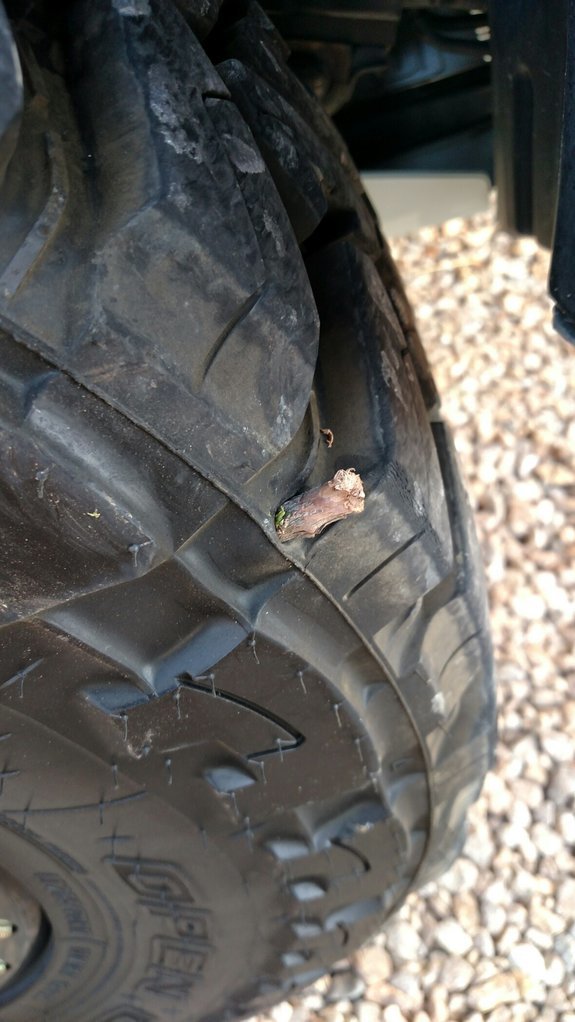

    just a question...i got a nail in my rt rear tire....its in the middle of the tire thread on the fat part....all sensors were reading 33-34 after 10k service in which the dealer loaded tires with 29psi....now the right rear is consistently 2psi lower than the others.....its been two weeks.....question: if i go to tire dealers and have them pull out nail and the is no leak, i'm ok....but if it leaks, is there anything they need to do after plugging the tire in regards to the tpms sensor

    This is a dangerous plug...WAY too close to the sidewall. You can see it bulging out. Hopefully only a temporary fix for you.
    Also plug repairs from outside the tire are not warranted by the tire manufacturer. Great in a pinch as a trail/side-of-the-road thing, but not long term on anything you care about.
    That said, you can get that plug kit and do it yourself for like $10...look on Amazon. I carry a set of these, an air compressor, and pair of diagonal cutters instead of a spare tire.

    Lol. That's the stick in the tire. I know it can't be plugged. That stick means business.

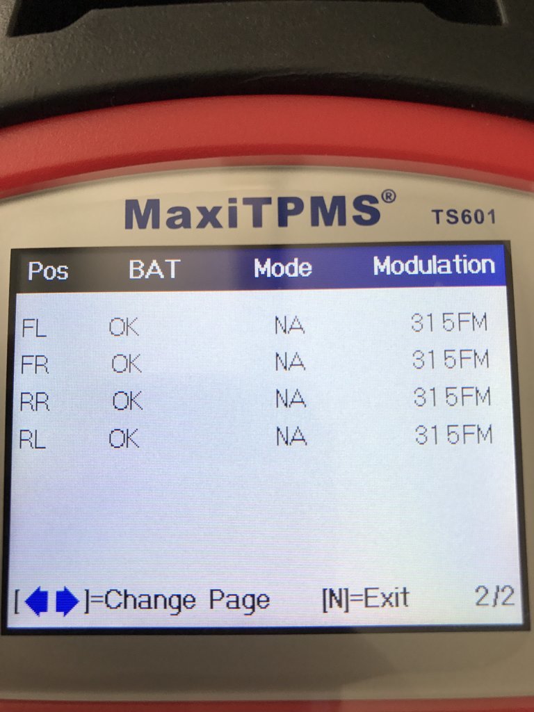

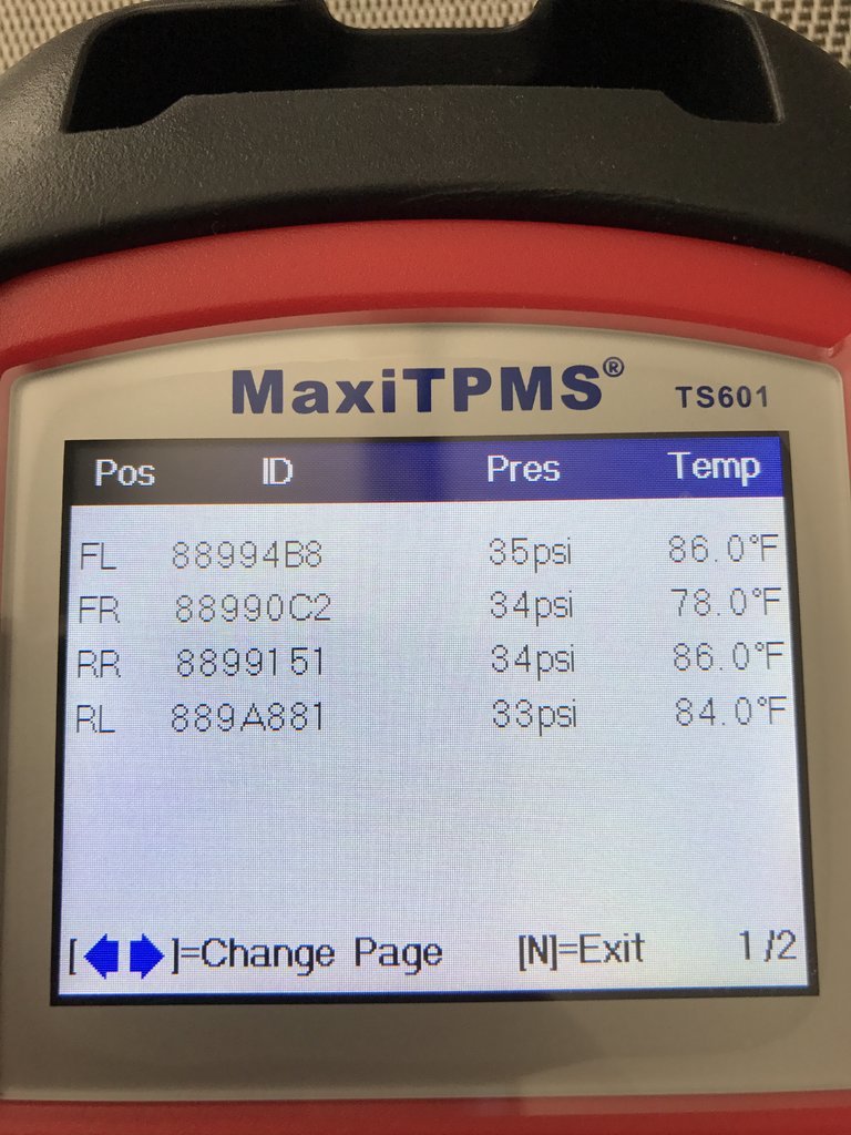

    Just some basic sensor info. No need to deflate or do anything to trigger the transmitters. The programming tool can trigger a receive signal as the sensors are constantly broadcasting.

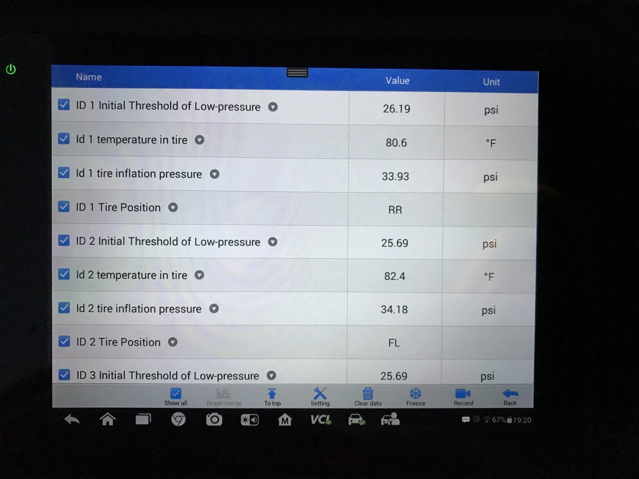

    My other scanner can provide more info direct from the TPMS ECU such as low pressure threshold based on where you reset the sensor pressures initially. More detailed info can be displayed from the vehicle side. This was not from the same session as info above.
