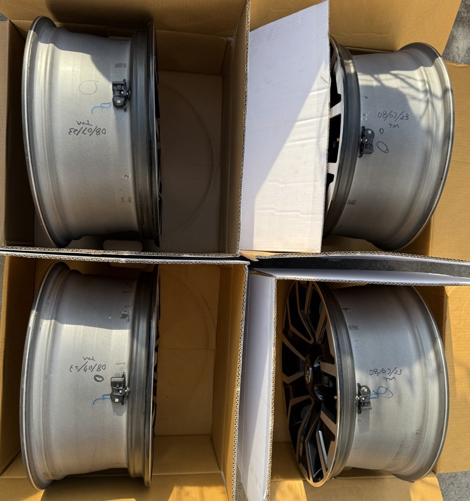

    Is it possible to remove the OEM TPMS sensors from 2023 TRD Sport wheels or is there a high possibility of damaging them when removing?

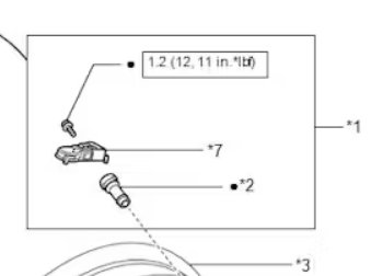

    They just unscrew from the valve stem, don't they?

    It's stupid, its not you. You need new stems, they are 1 time use. #2 in the pic.

    Most of what I have seen is they have a hex on the front that you unscrew and slide the stem out the back. Took me about 45 sec. per wheel (without a tire installed of course).
