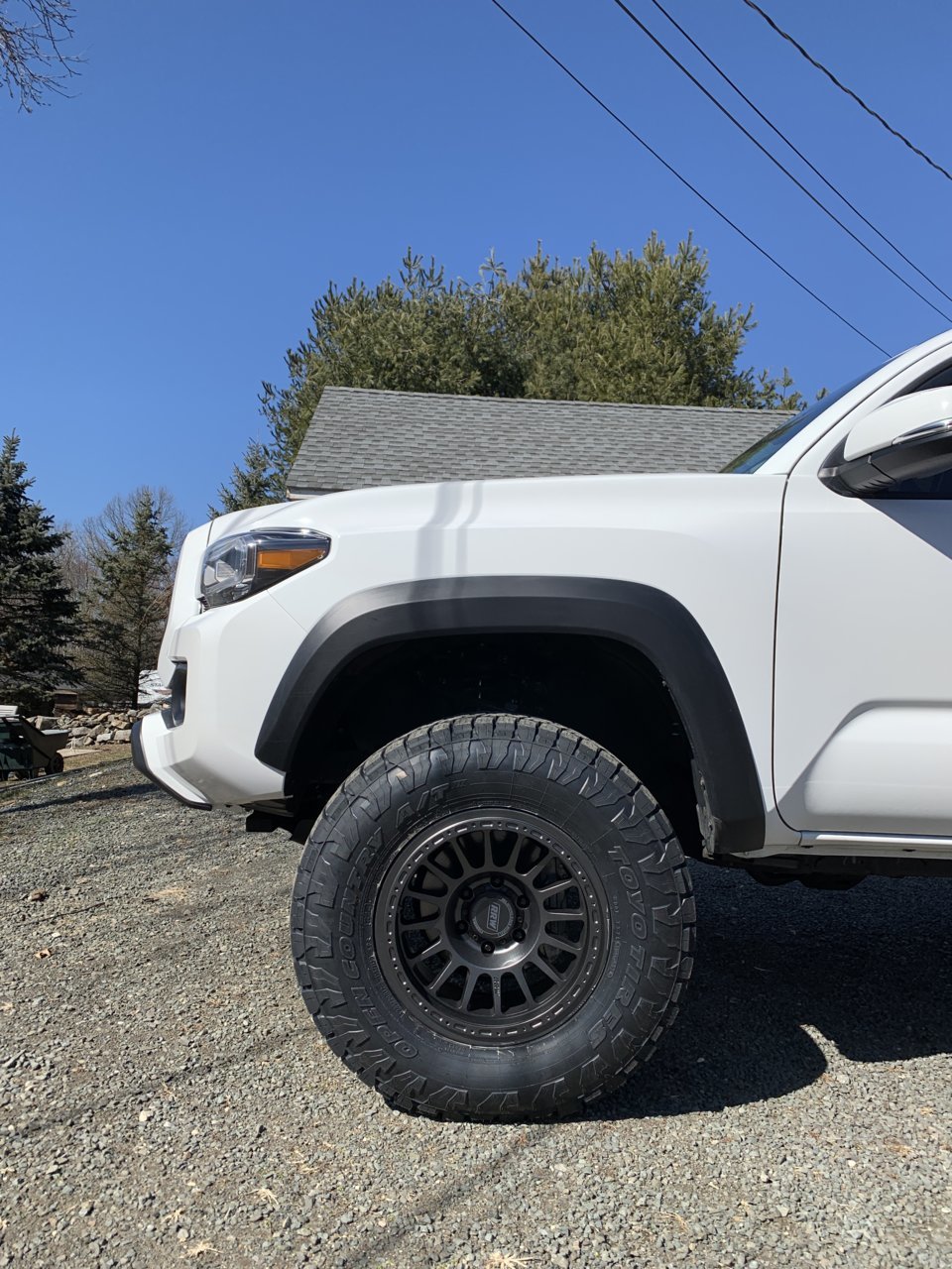

    Got a set of RR6-H wheels today, went to Mr. Tire to get them mounted and they said the stock TPMS sensors from my 2021 TRD Sport wouldn't fit properly in the RR6-H wheels I have, and that air would leak if I wanted to add the sensors to the new wheels. They mounted the tires to the wheels without the sensor.
    Anyone else have a similar experience? Is there certain way to add the sensor to the new wheels?
