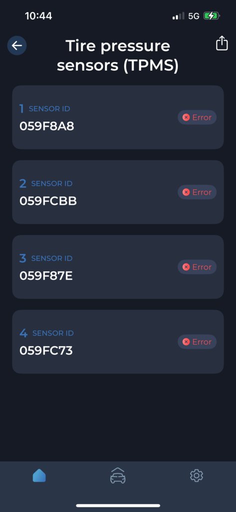

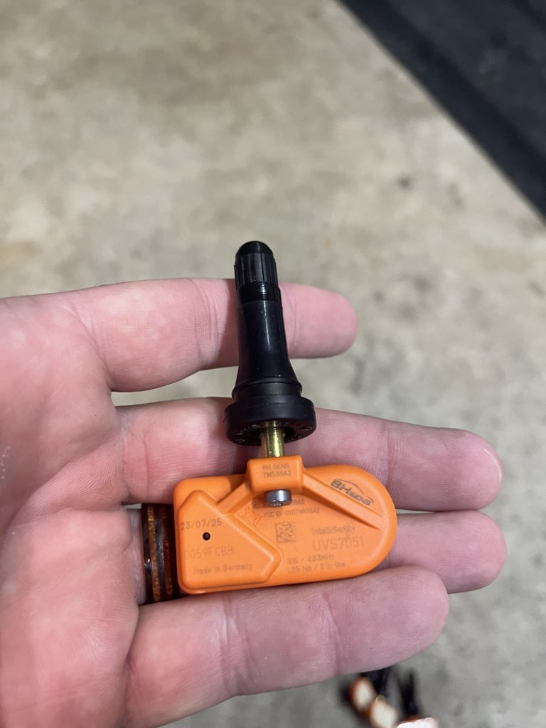

    Ok, I bought all new HUF preprogrammed sensors for my 2022sr. I had the sensors and tires installed at a mom n pop tire shop. They don’t do tpms per se. anyways I have the Carista evo and manually inputted the new sensor ids into the app, I still get the flashing warning light. I have put over 250 miles on the tires and nothing yet. I looked in the manual and held the button and it won’t flash slowly 3 times. Anybody know what I might be doing wrong? Driving me nuts with that damn light.

    Also the Carista says error under each sensor in the app.

    You say you bought "pre-programmed" sensors. Are you sure the codes match your old sensors? Pre-programmed means to me, programmed with the same codes as your old sensors.

    Any chance you missed the leading zero? Looks like there are 2 of them on the body housing.

    Bunch of reviews on the 'Zon where people say those sensors didn't work on their vehicles. Could be the same issue for you OP?

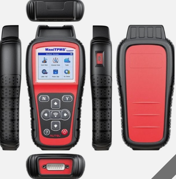

    I got a set of the Autel ones for my other set of wheels and a Autel MaxiTPMS TS508WF TPMS Relearn Tool. I reprogram the TPMS on my own and whenever I feel like it. Makes swapping wheels super easy.

    My OEM sensors only had 7 digits as well.

    Well I guess I put the wrong numbers in, TPMs told me what numbers I needed to input. I’m just glad I took pictures of all the numbers on each sensor. I logged them into Carista app and they popped up and working. No more idiot light. I changed my steel rims to TRD wheels and 2 of the sensors were screwed. TPMS direct pre programmed them and I had installed Mickey Thompson Baja boss a/t tires. All is good and I just inputted the wrong numbers. Thank you all for the replies. The HUF sensors are all good, in case someone goes that route. I have them the VIN# to make sure everything was accurate. $110.00 for all four shipped.
