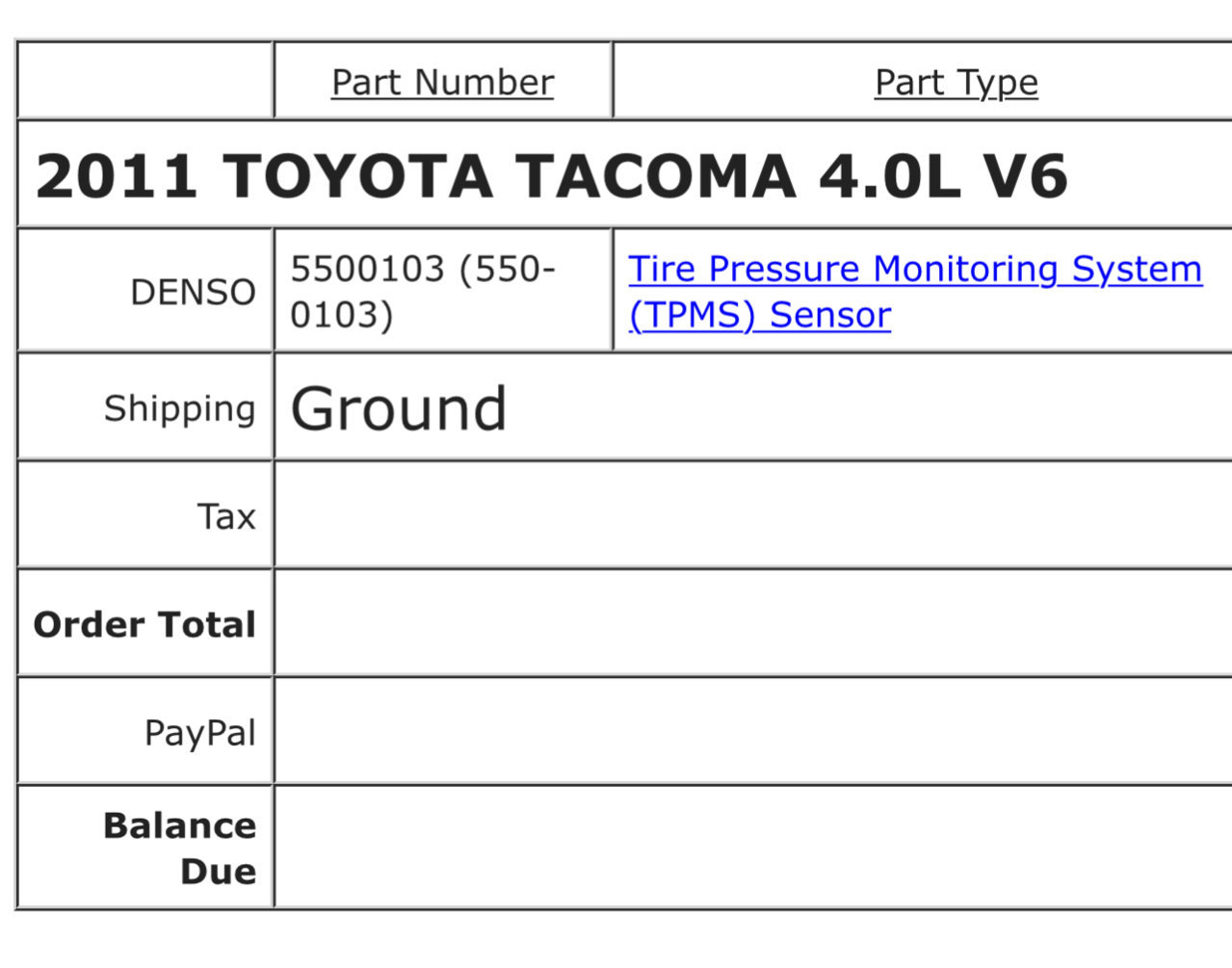

    Ok so I just got some aftermarket wheels for my '15 tacoma and I am looking for some TPMS sensors but how do I know if they will fit my rims. I know they need to be the 315 mHz. But how will I know if its long enough or if it fits in the hole?

    They have them for alloy rims. And they have them for Steel rims Really only difference there. Get the preprogrammed ones much easier to calibrate.

    On rock auto I am seeing a VDO / CONTINENTAL SE10007 and a VDO / CONTINENTAL SE10002A I am not seeing a difference besides like $10

    nevermind I found the oem ones on there

    Mine are for Alloy Rims. See pic
    You should be the same

    I put those exact sensors in my 17" rims from a 2012, on my 2006 when I put on new tires last week. the tire shop that put them in tried telling me they were bad and couldn't get them to activate. The next tire shop got them to activate but couldn't get them to write to the truck, kept getting an error message. they wouldn't take a dime though, since they didn't get it all the way done, and wrote down the id's/positions for me, great local shop! Toyota dealer want's 175 bucks to put the id's on the truck. I bought an Autel maxi ts601 from Amazon that arrives today. I noticed others had the same issue on the forum, but I couldn't find a detailed solution other than paying someone to do it. I'll check in this evening to let you know if it played nice with the sensors and truck or not.

    So I’ve got the same denso 550103 sensors in all 5 tires, and the Autel maxi TS601 that came from Amazon made short work of what two different tire shops couldn’t accomplish. I’ve never done that process before and I’ll say the tool was at least 90% intuitive, with a question mark button to guide you through the proccess. Fabulous tool!!!! And it’s on sale for 299, just 125 more than what the stealership wanted to do the proccess once! And it does a ton of other stuff to, live data etc.
