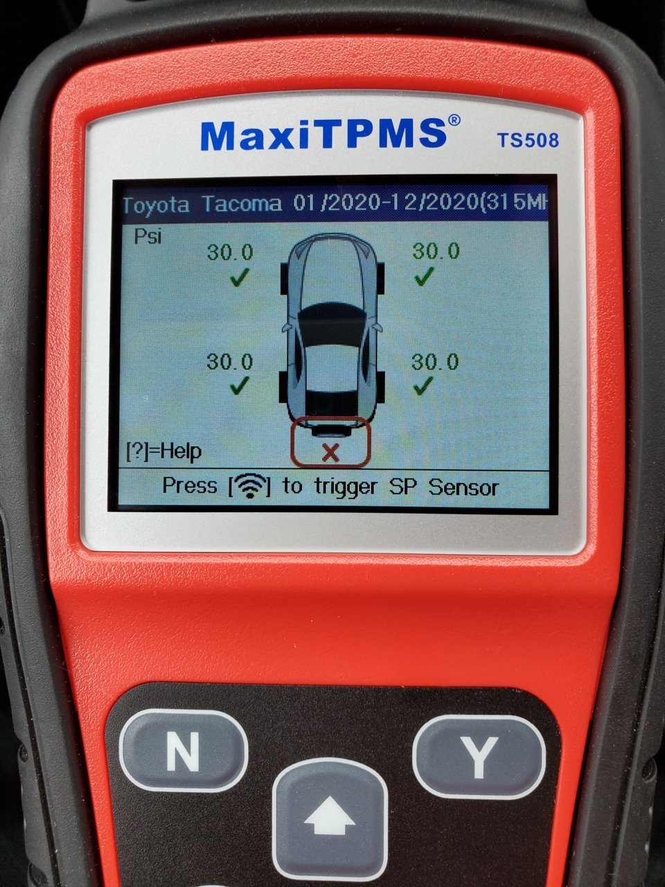

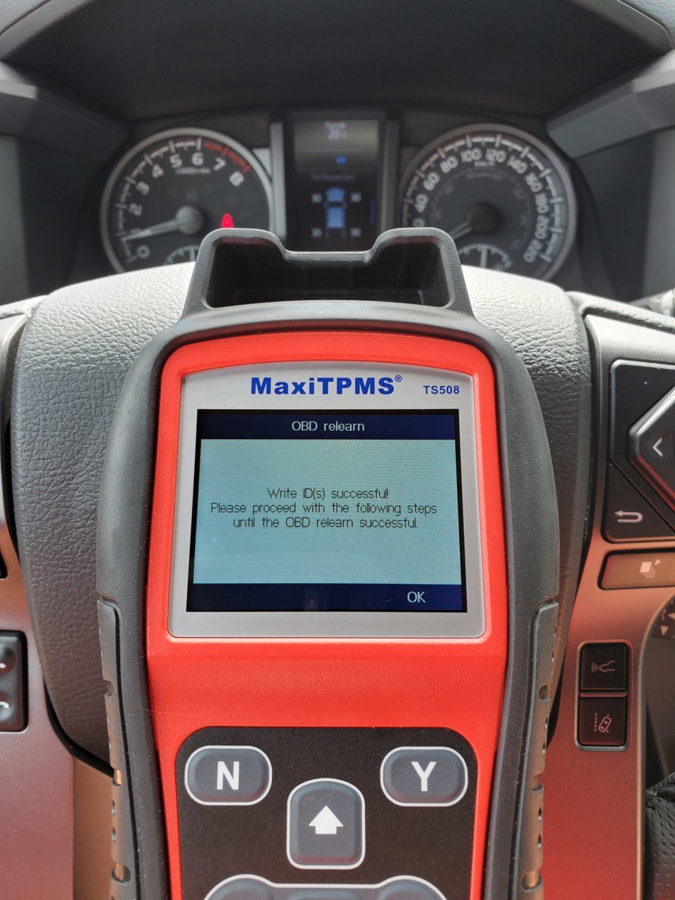

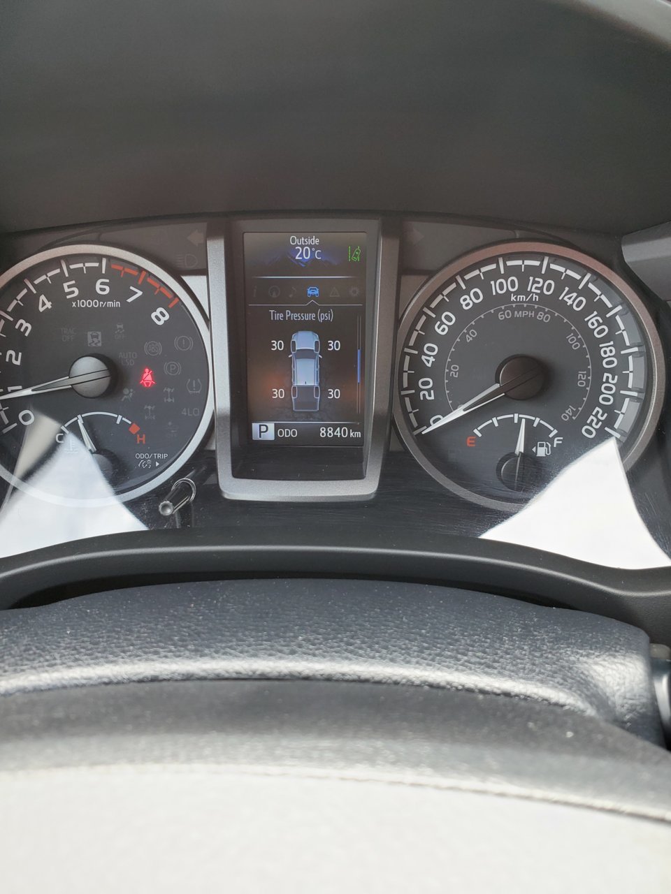

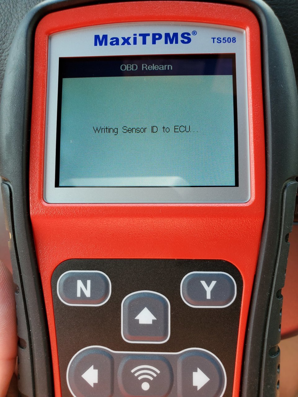

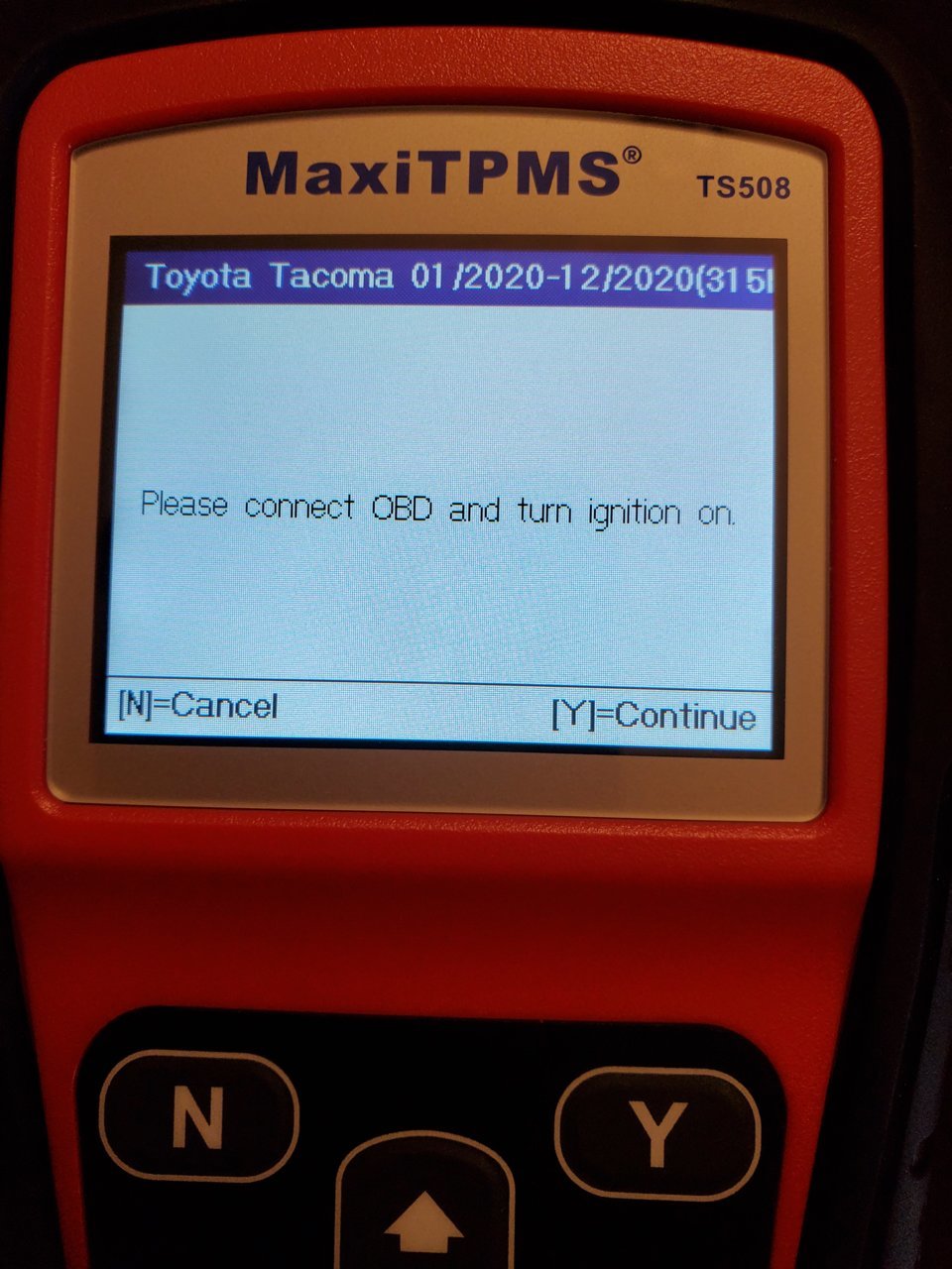

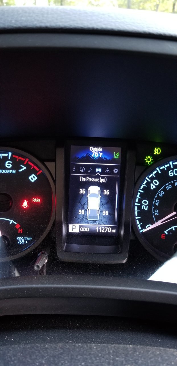

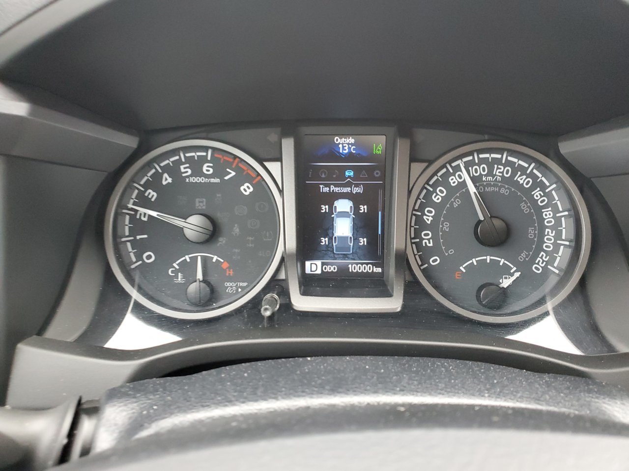

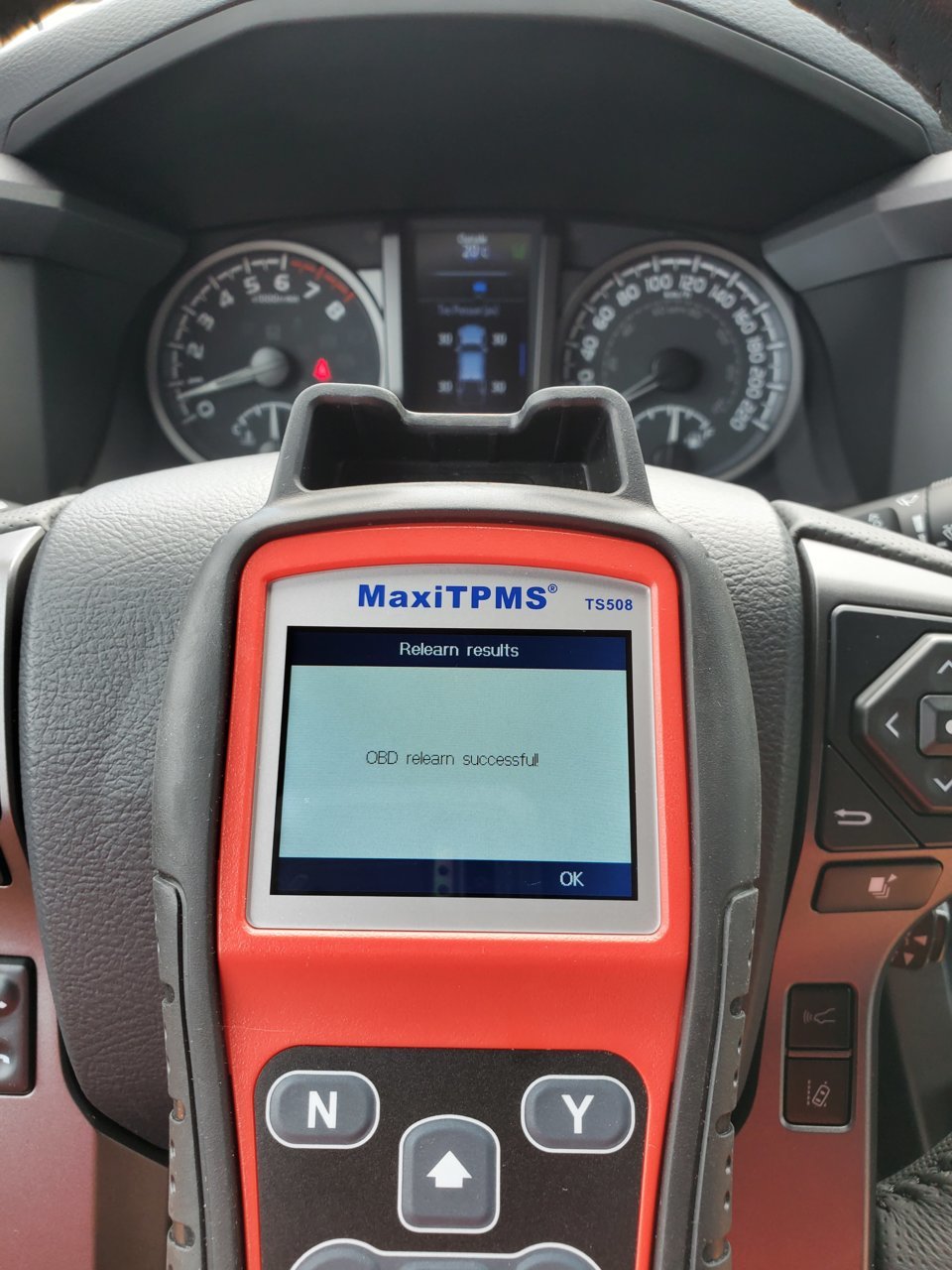

    I have the Autel TS-508 and did a TPMS relearn for my new set of wheels with different set of TPMS sensors. Easy with TS-501 or TS-508...
    Trigger all 4 TPMS sensors, connect TPMS turn on truck, write Sensor ID's to ECU. Relearn complete. (Spare tire is not stored in the ECU, only 4 tires are stored.)
    *** NOTE *** You must select the spare and cancel triggering it to continue to the next screen for writing TPMS information to the ECU.
