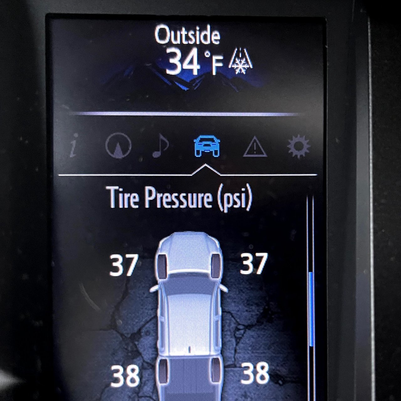

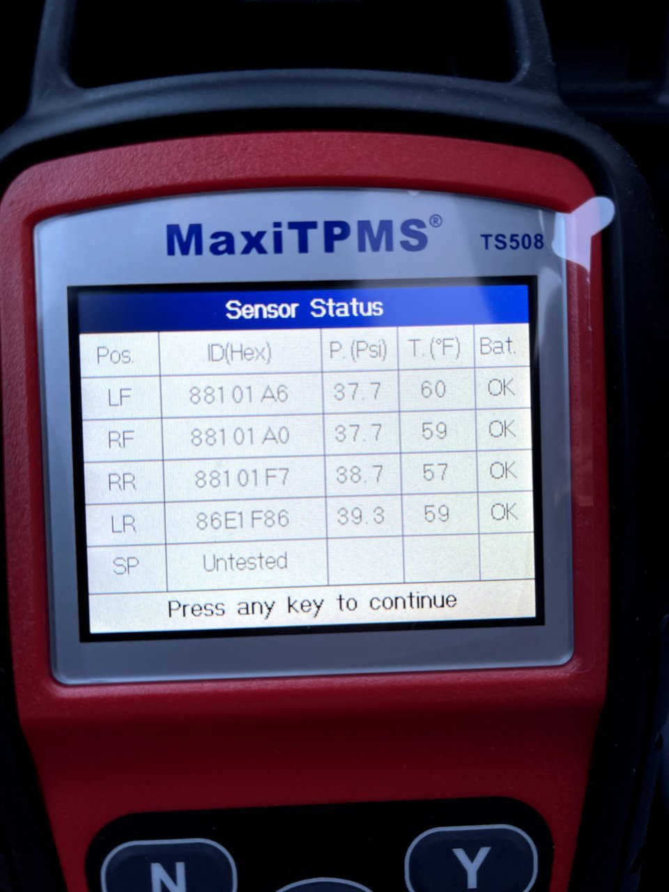

    Just got the TS508 and was having problems writing sensors to the ECU (installed by tire shop). The problem was that I didn't add the spare, and didn't cancel it either so it just waited for me... the tech support figured it out right away. Now all I need to do is drive for +10 minutes at 20mph+...

    As it should be.

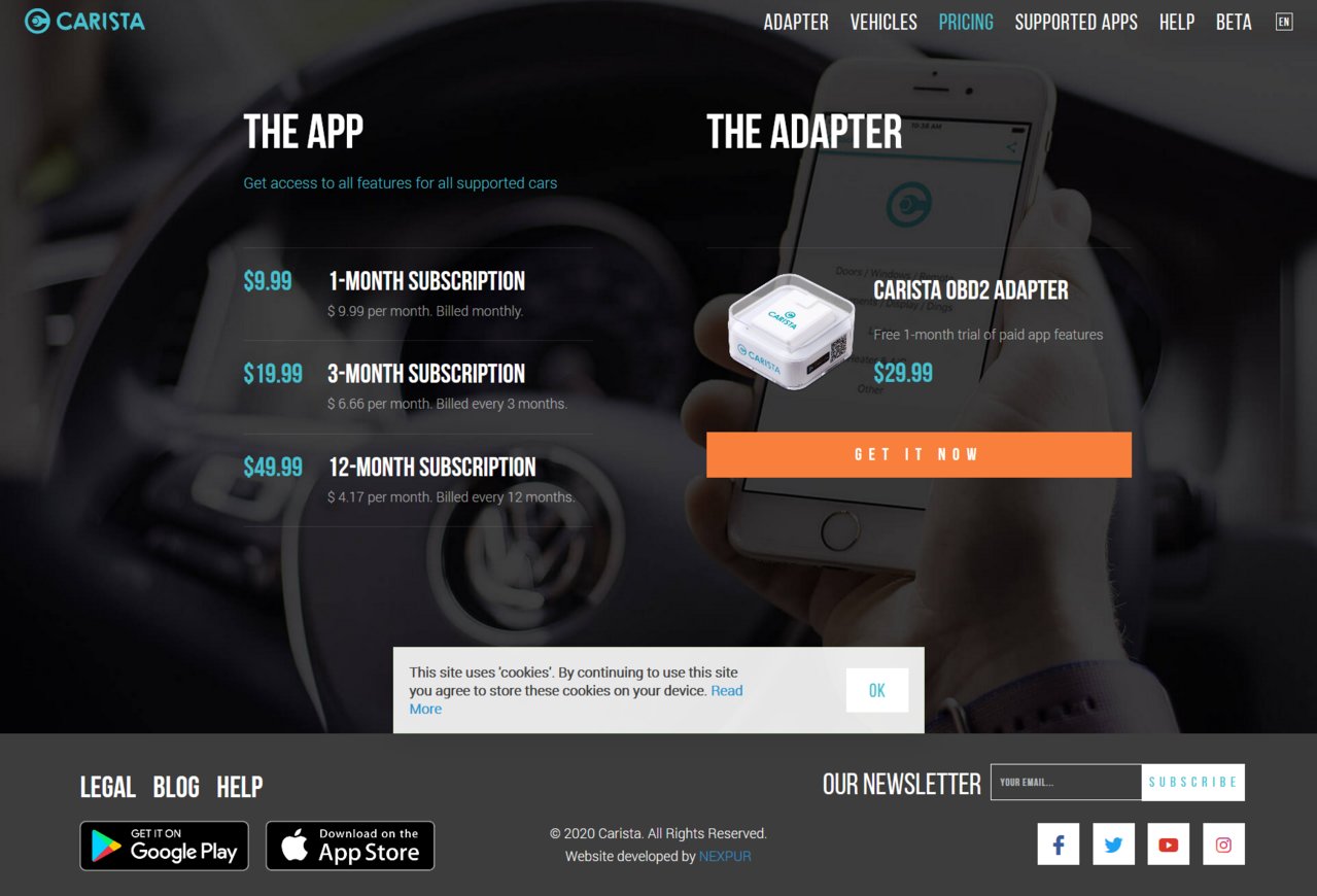

    I used Carista you just have to have the codes to each TPM before installing them.
    Screenshot_2020-11-24 Carista OBD2 pricing Unlock your car’s hidden potential.jpg
