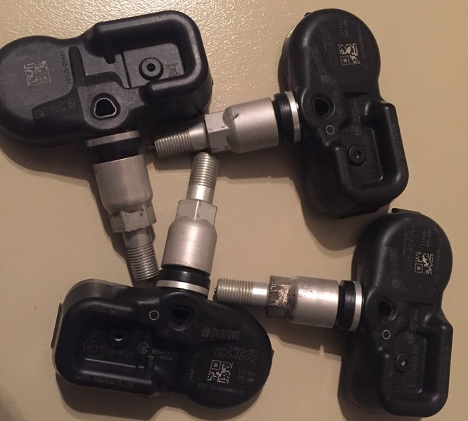

    They are about $50-$60 each from cheapest online Toyota part centers. My dealer wanted $550 to install new wheels/tires/ and provide new TPMS sensors. I can understand why people keep their original sensors. I found "like new" used ones for $60 for 4.... We will see if I regret it...

    The buyer of my OEM wheels negotiated on the price to include the TPMS sensors. I knew the price of new and used ones and took the guy up on his offer for my wheels and sensors. But the fact that they are reusable explains why the vast majority of wheels listed for sale do not include the TPMS sensors.

    Considering that the 2016s use a newer TPMS module, they are harder to find used, and the 2nd gen older ones don't work.
    I imagine that is why people are keeping and using them in their new wheels.

    Well, I might be in trouble then. I called the dealer, got the part number for the TPMS sensors. And ordered that part number online. Pretty sure it was the same part number as the 2015. We will figure it out when they come in and the selling of my stock rims take place next week

    Appears you need TPMS PMV-C015.
    https://www.tacomaworld.com/threads/compatible-tire-pressure-monitor-sensors-tpms.404296
    https://www.tacomaworld.com/threads...ating-tire-pressure-monitoring-sensors.406287

    Looks like my Dealer gave me the wrong info again. Love working with dealers... Now I need to find TPMS sensors before the end of the week...

    Called another dealer, gave them VIN#, and they quoted same part#: 42607-06011.
    This is the part# I ordered. I guess we will see if they are right when they get here and I have my new wheels installed. I would have just ordered the part number you gave, but I can't find any of those anywhere.

    Just like the other threads, you're going to have those TPMS modules installed and they are probably not going to work on your 2016, causing further costs and troubles.
    Hate to say this, but probably better to renege on your sale, and keep your original TPMS modules.
