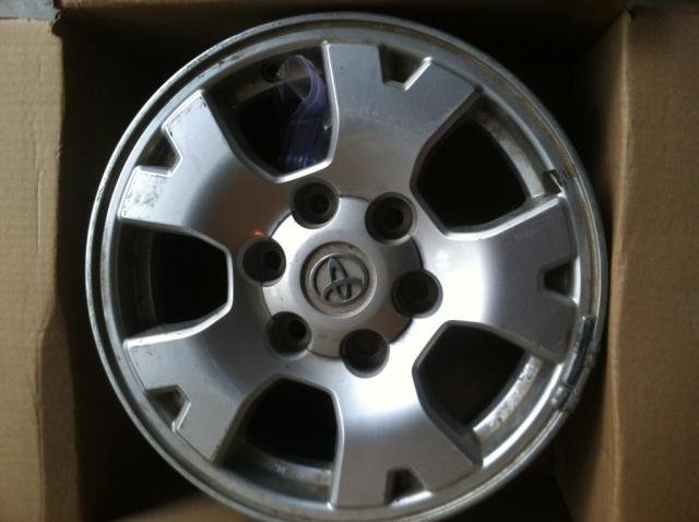

    I have 2013 steelies and putting on some older (guessing 2009ish) TRD offroad wheels like this one:
    I know there is some kind of rig you can do to use the TPMS for steel wheels on other style rims but I can't find it searching.
    So,
    1. What is the way to make it mountable (different angle tpms, I believe)
    2. Anyone have Toyota part numbers for both styles? Will help if I have to end up ordering new ones or going ebay route.
    Thanks guys

    Turn the TPMS 180 degrees. Worked for my steel to FJ Cruiser alloy swap.
    Just make sure you tell the next tire shop about it so they don't break the TPMS when dismounting next time.

    On an '06, Firestone did exactly this. They flipped the sensors from the stock steelies 180 degrees when I had them mount new tires on 4Runner alloys. They were still on there when I sold the truck after a year.

    Well I finally took my TRD OR rims in to do the TPMS swap and get new tires mounted. Shop wouldn't try flipping them 180 degrees, said they didn't want to be liable if they broke. They said $65 each for them to source new sensors. I found these on ebay: ebay TPMS
    What do you think? $50 for the oem set sounds pretty good to me.
